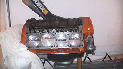

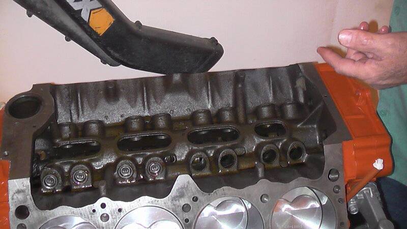

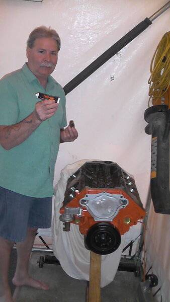

Joe GIBBS AND I got the lifters lube up,love his assemble lube.now just have to wait for my heads.
