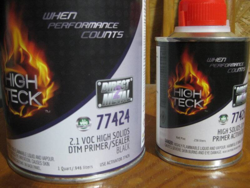

I'm finally getting to painting the body and so I went to the auto paint supply store and got the pictured primer. I requested primer for blocking and painting single stage. This is what they sold me. That's all fine so far.
After buying the primer, I learned that Chrysler Formal Black is no longer available in California in a single stage paint. That's the California smog Nazis for ya. I won't get started on that...
I really didn't want the look of base/clear, plus I have more experience with single stage, BUT... if I can't find a way to get the color I want in single stage, and have to use base/clear; can I put it over this type of primer? Does the primer matter?
