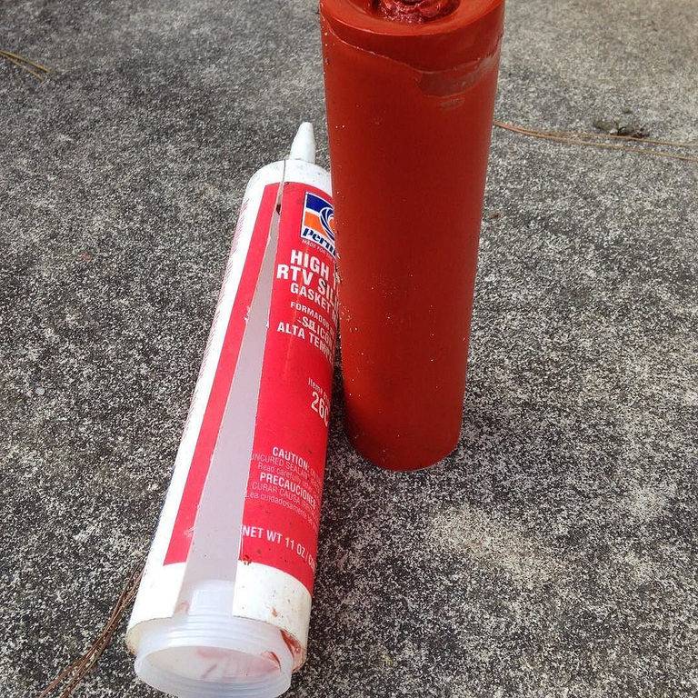

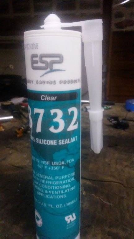

How do you keep a tube of RTV-silicone from setting up in the tube after it has been opened? I buy a new tube , use just a little of it , put the cap back on tight , and a month or two later it has set up near the top. I wish the manufacturer would offer a pack of 6 or so in a box. Use the funnel tip , and plan on throwing it away after one use ......................MO

If it's dried real bad at the tip I've cut a bottom corner off to get another use.

I fill the cap almost full, I put a nail into the tube, then screw the cap on. The nail head seals the tube from the pressure from the stuff inside the cap as you screw it on.
I buy silicone in tubes with thread on ends. After i use it it hardens in the end. The next time i use it, i unthread the end and use the caulking gun poker to push out the hardened chunk. I can use the whole tube.
