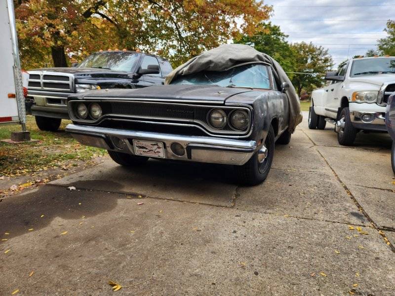

So I somehow ended up with a somewhat doozy of a car that good friend left to me (69 Roadrunner) and it needs a fair bit of work, mostly in the back half. Floor, roof, front frame rails, torsion bar crossmember, interior, windows, etc. are all intact and in relatively good shape aside from a lengthy date with flap disc where there's surface rust.

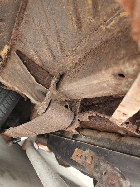

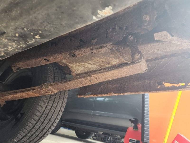

However, the problem is the back half. Quarters are rotted at the bottom, as is the trunk floor, etc. Rear frame rails are swiss cheesed behind the tires all the way back but the leaf spring perches are still holding, for now. Most people might just say dump it and find a clean one, but it has sentimental value so I'll be giving it my full attention.
Question is, where do I even start with this? The rear portion of the rear frame rails need to be replaced, trunk floor, quarters but I have no idea what order to tackle these in. I feel like if I try and remove the rotted trunk floor and frame rails then the car might lose structure and start twisting. Maybe weld in some support rods to keep the rest of the body in shape? Or will it be fine if I cut out the rear portions of the frame rails and weld in the new ones I have on hand along with the trunk floor before I do the quarters?

Make up bracing and jigs to hold the location of the frame rails, 'cause it looks like you need one or two. Set the car level and make some measurements BEFORE you cut anything. You have to fix the frame first. What do the front rails, crossmember look like?

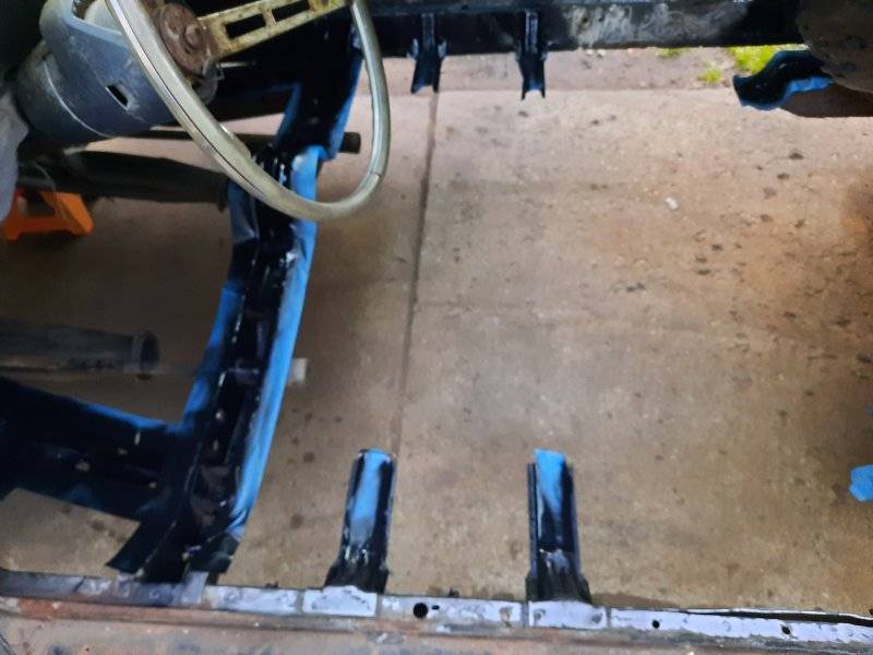

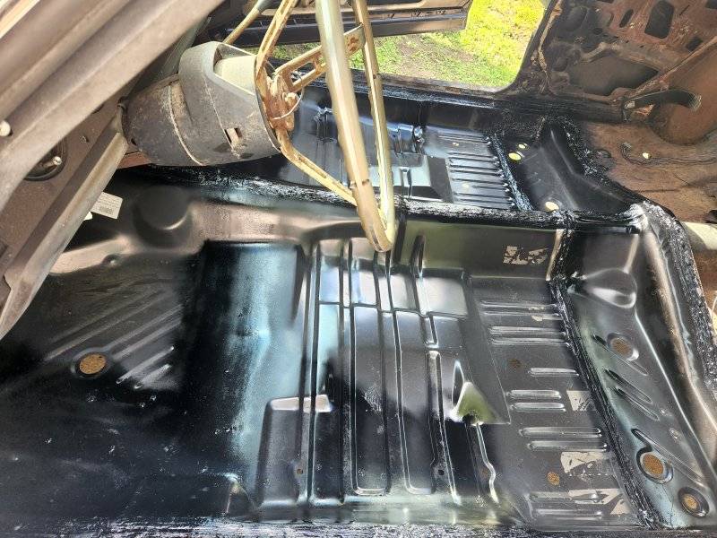

The front part of this car is in much better shape than the back. It’s as if someone parked this car with the back half exposed to the elements for decades with the front warm and dry.
Front rails and crossmember are solid, as is the floor pans, rockers, roof, etc.

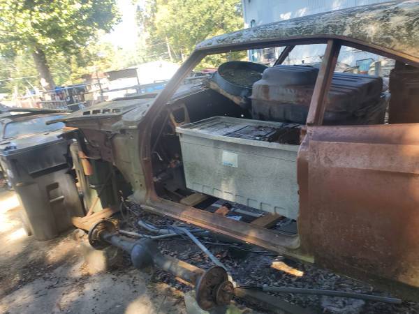

There is a Satellite near me that has been on craigslist for a long time. Its pretty much gutted however,the frame rails and the actual unibody look to be in decent shape. It does need all of the floor pans but if you don't have to do the frame rails it may save a ton of work. I'll post a link to the car. It may be worth having it as a back up plan. This is a post car so it may not be what you have but certainly useable. Pretty sure the guy would take less. Hell its been on craigslist for I know well over 2 years.
