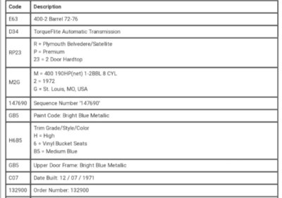

Hi , my son in law came round yesterday and has recently de coded his '72 satellite vin plate . We decided to check my satellite sebring+ , everything matches up , engine , colour etc etc all ok except for one thing - my car de codes as being born on the 7th of December 1971. We went a little further and discovered all the glass also decodes as 1971. The rear lights and side markers etc are all 1972 year model.
So, the question is can anyone tell me at what point ( production number ) did Plymouth stop 1971 and move to 1972 ? My view at the moment is that I have a very early 1972 car built in very late 1971 , I say very late because the factory MAY have closed down for a few weeks over christmas meaning my car MAY have been one of the very first 1972 cars built in december 1971.
I'm not a geek or purist but I'm very intrigued- any help would be greatly appreciated
I've added a pic of de code

A model year in the States begins August 1 of the previous year as KD stated. It is not uncommon to see previous model year parts used into the next model year early in production or the next model year parts starting to show up in a current model year late in production. Your car is definitely a 1972 model car.
According to the table you posted.
Your vehicle order number (VON) is 132900.
Your vehicle identification number (VIN) is 147690. Your car is the 47690th VIN assigned at St Louis that model year.
Your scheduled production date (SPD) is C07, December 7, 1971. It may not have been built this day.

I have a registry for 71-72 Plymouth B bodies. The earliest built car (scheduled production date) I have for the 72 model year is July 14, 1971. Your car is right in the middle of the 72 model year production run.
