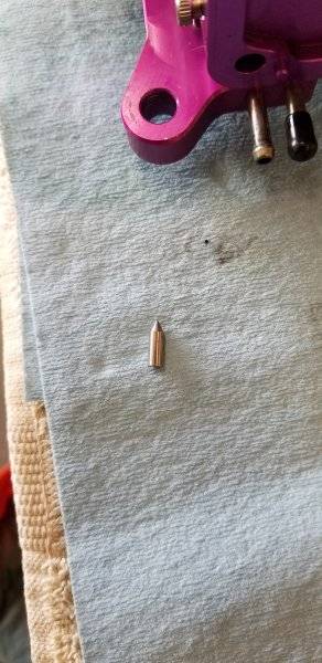

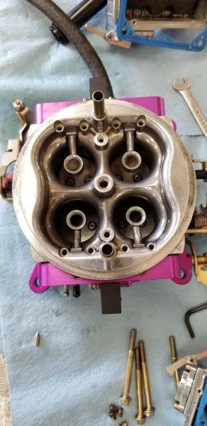

I removed the carb, Proform 850 DP, from my GTX for a clean up. I have not driven this car for almost a year so I wanted to clean everything up before engine start. With carb on the bench I removed the bowls, jets, and bleeds to shoot some carb cleaner through the passages. I did not disassemble any further that that. I did not disassemble the bowls. When I turned the carb upside down to facilitate drainage of cleaner, a needle fell out of the body. I don't know where it came from but I'm pretty sure it came from the front of the carb. Anyone know where this part goes?
Under your accelerator pump discharge nozzle or squirter
Yup. It was under the screw for your squirter nozzels.
Copy that. Which way does it go back in?
And shouldn't there be two of them? One for primary and one for secondary?
