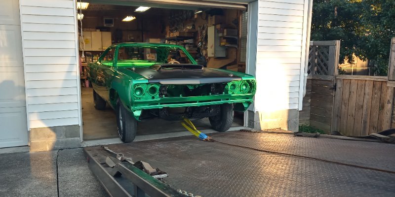

Finally, almost 3 years to the day it left, it's back here
It still has the speed holes, mini-tubs, and the springs are moved into the rails so it's not completely neutered now.
More to follow.
