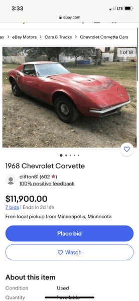

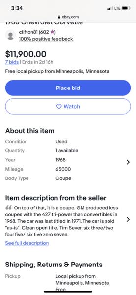

Urgent alert after I’ll take a break. Real 427 tri power corvette no reserve 2 days left. Has matching numbers trans engine even has the tri power set up with it.

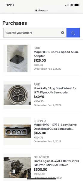

so 23 spline a833 transmission 500,bell housing 400,adaptor 150,pistol grip 295, linkage 115, clutch assembly 180, e body tail shaft 275. I have my separate bundle a superbee full vin code hard to find case 250,and b body tail shaft 100.

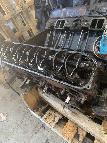

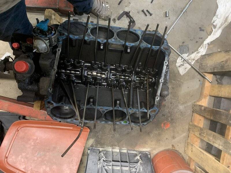

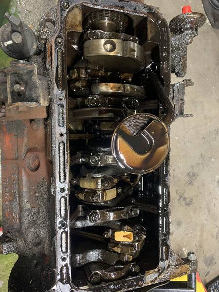

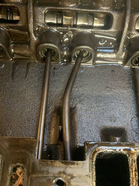

Bent push rod at number 4. Oil looks new. It was recently pulled I’d say up to 3 years ago. So far we found out why it’s not running. I’m putting it on the stand and going to clean it up.
We are just going to replace the push rod and make it into a 2500 dollar running 440 is the hope so far.
I’m going to delve deeper into it to see if theirs anymore problems that I’m worried about like out of timing and spun bearings via cam shaft and crank.

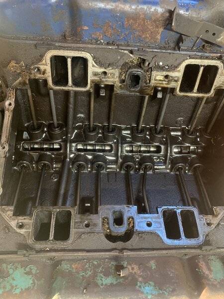

I was wrong it’s been sitting up for along time but not under rain. Metal shavings-a possibility of a dud but we will see. Heads look good and oiled without built up sludge it looks. I’m going to get the filler gauge out and check the lifters maybe.

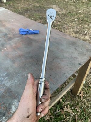

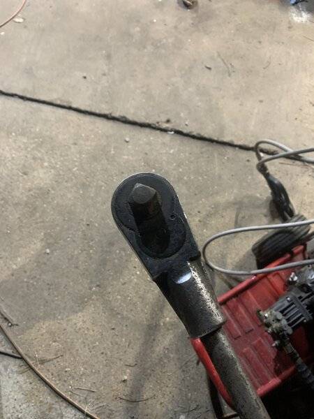

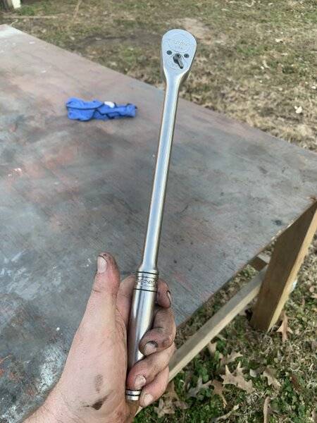

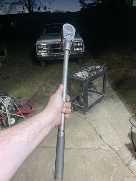

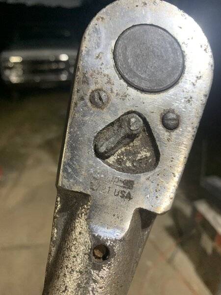

This we have had for along time this is a great power ratchet handles emense stress. We also have a crank bolt 1 inch drive snap on ratchet that’s ultra antique I wouldn’t sell it for 1000 dollars it’s been there through thick and thin. I want to send it off to a restoration shop- which reminds me someone needs to go into the tool restoration business.. I love antique tools.
this is what I use for the head bolts and other high psi torque bolts on engines and other stuff.
I’ll take a picture of thr snap on antique 1 inch drive we have it’s been heavily used especially when my dad was a forklift mechanic.
me amd dad are cheap scates usually but we find ourselves in need of American made stuff sometimes. This is one of the house hold merchandise under home owners insurance..

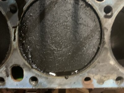

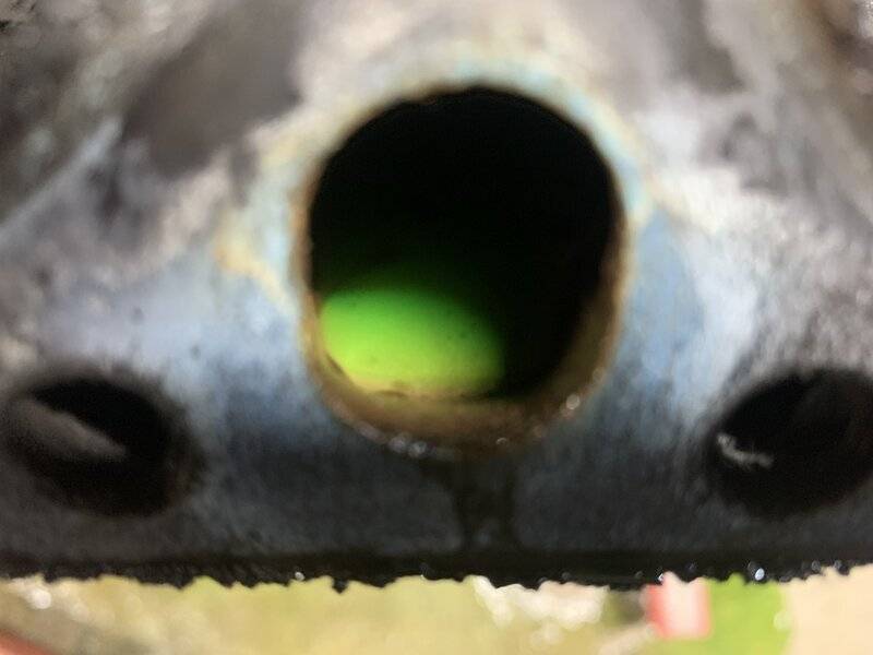

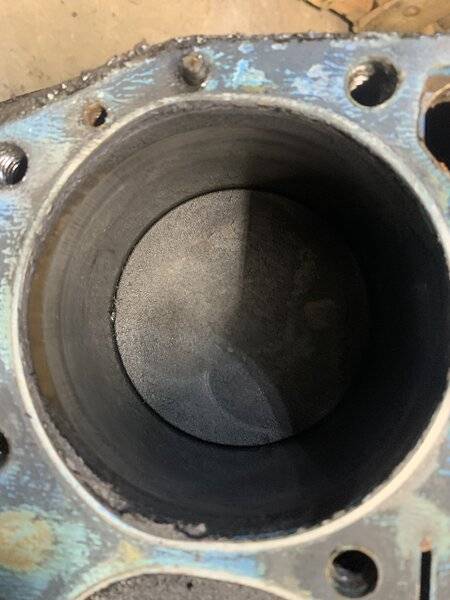

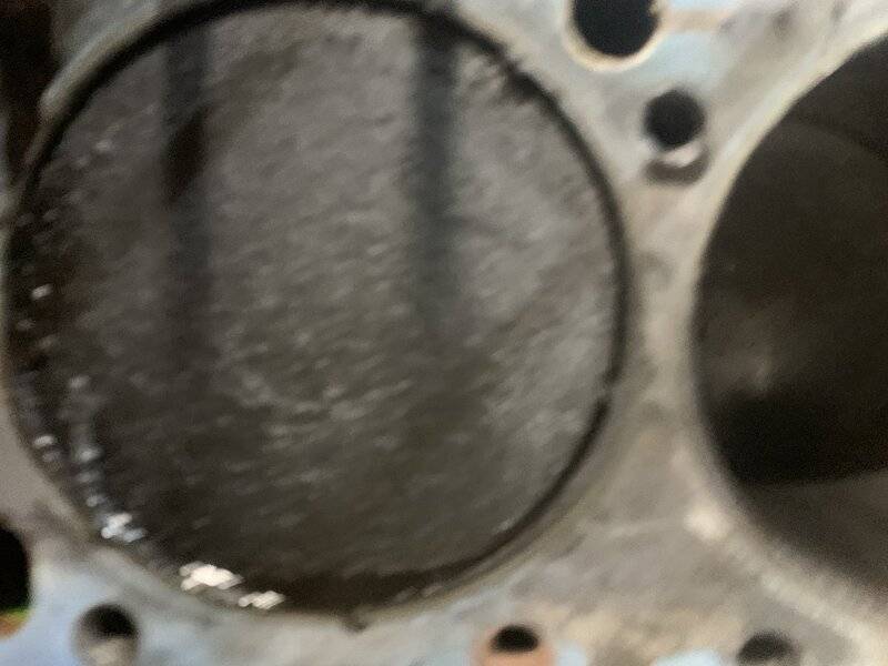

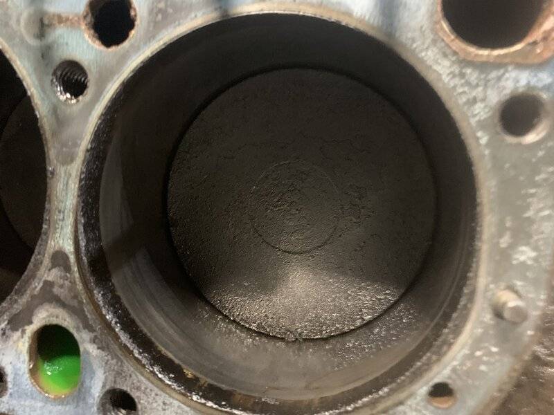

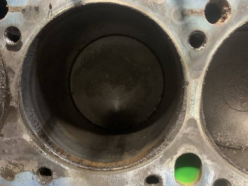

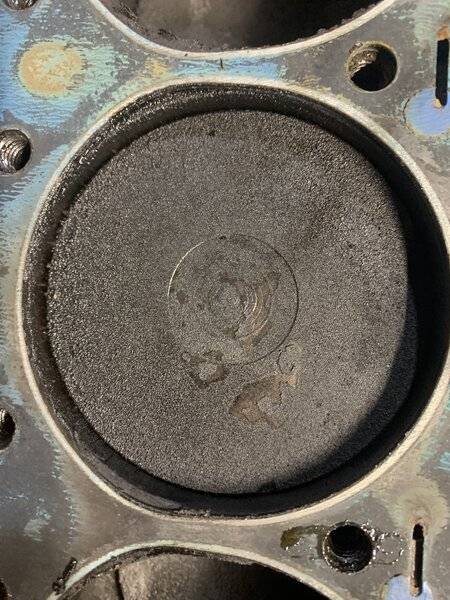

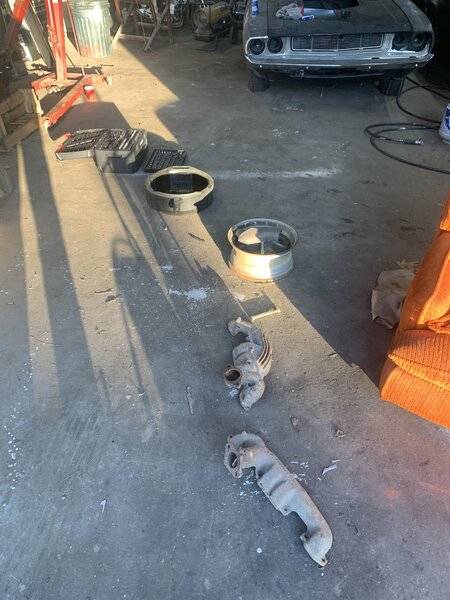

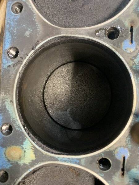

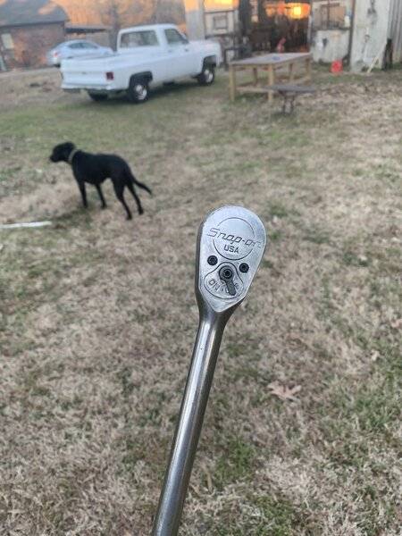

Updates clean cylinder and I captured it rotating also. Good compression hard to turn over. The above picture of the snap on ratchet look at the orange light in the barn-that’s weird because light and shadow is positioned in a different area that violates normal physics I believe.
the sun was really shining only on the door unless the sun positioned itself differently during when I was inside it. And the light intensity is inside the shop in shadow that’s wrong in artistic drawing design.. the brightest area should be at the door rivhecheting off the door.

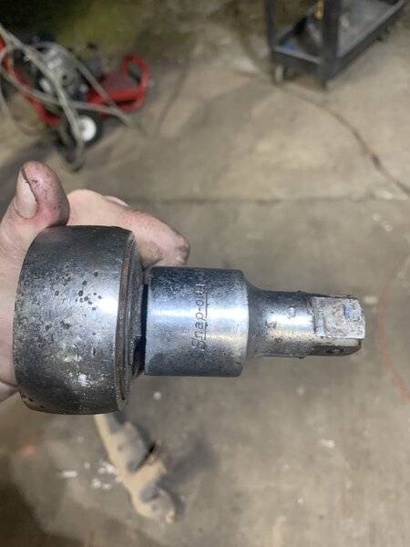

Looks like someone on the roof but it’s really a satellite lol still spooky. Here’s the really cool snap on 1 inch drive or 3/4 but i believe it’s 1 inch. This thing is a savior.

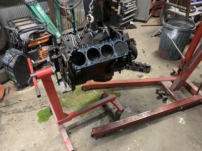

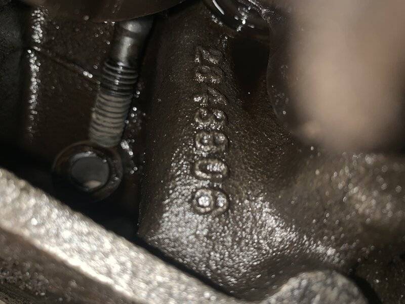

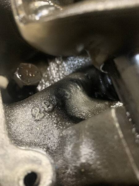

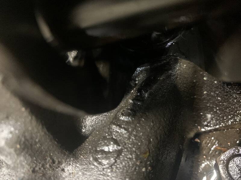

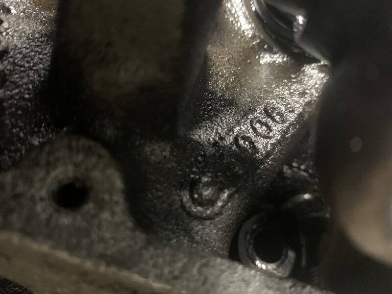

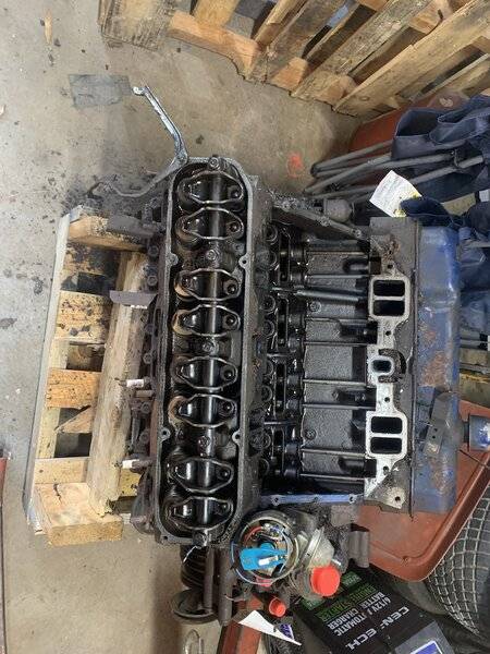

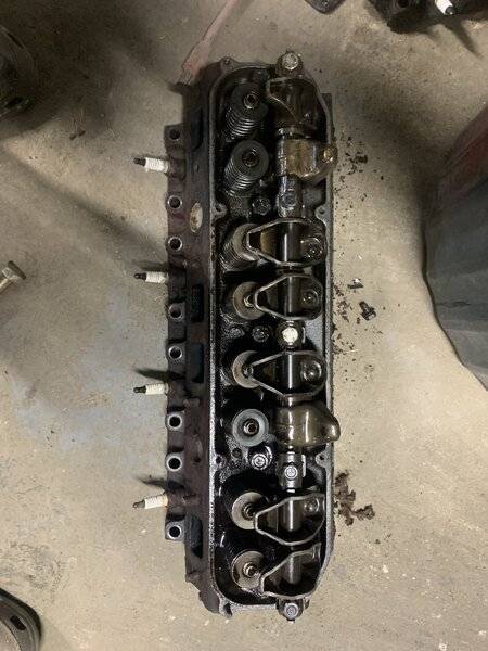

Updates. 906 heads. This motor is strange it’s early 70 heads, casted in 1970 January 23rd on the block. The punched area says g440 it should be f440… it’s like it sat for a year with no car and then they punched in g440 late 1971.
I didn’t use a filler gauge way to tight those valves are. I believe this engine is period correct for the challenger. I’m liking it even more. I got the other head off..

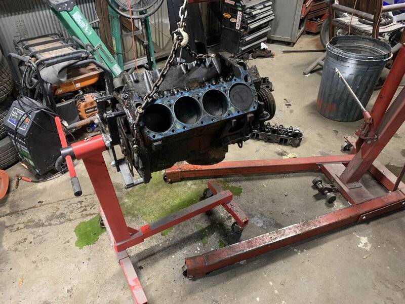

Now to put it on the 750 pound engine stand.
I wanted to take the heads and intake off so the weight won’t be as much on this cheap engine stand that I only trust with a complete 318.

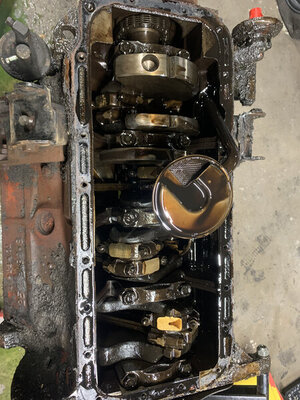

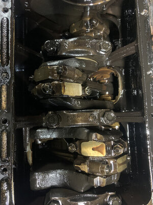

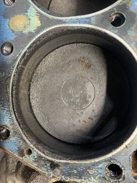

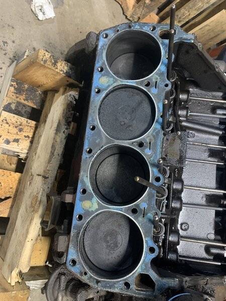

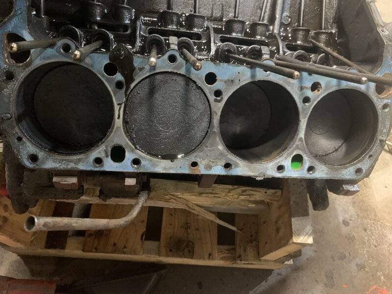

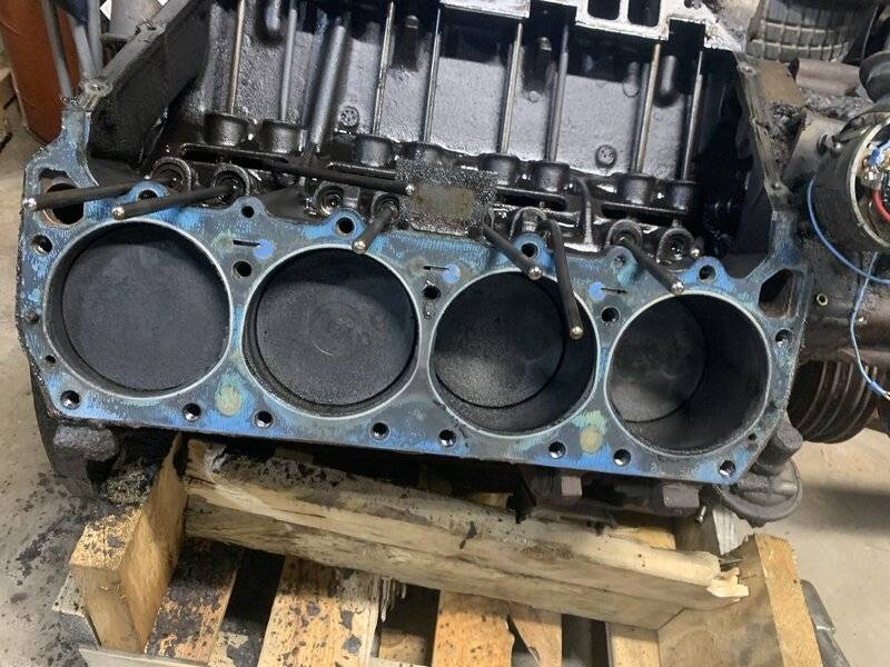

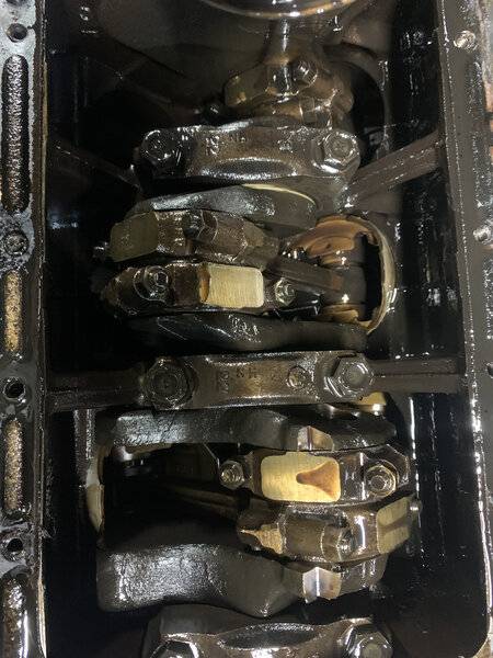

Fresh antifreeze. No cracks so far. Standard bore all original pistons to rods to steel forged crank.
the steel forged crank was found in 1966-1971.
I believe in 1972 they started putting cast cranks in these motors but I’m a very forgettful person.
meatier swing arms and pressed casting. I will update later on.
we believe we are going to use this to build with six pack rods because the original pistons have heavy compression,ring gland isn’t even there so it wasn’t used hard. It did have a very bad oil leak so it was driven a lot.

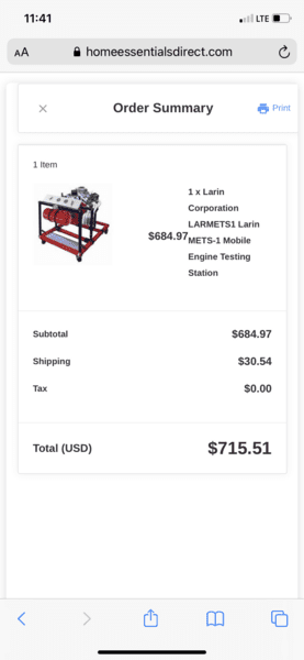

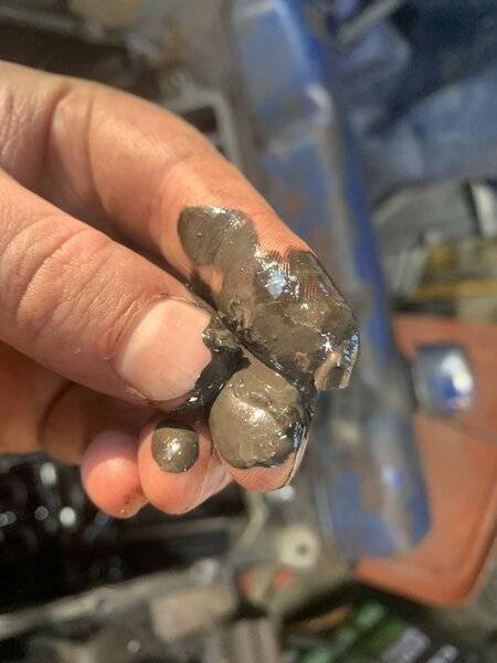

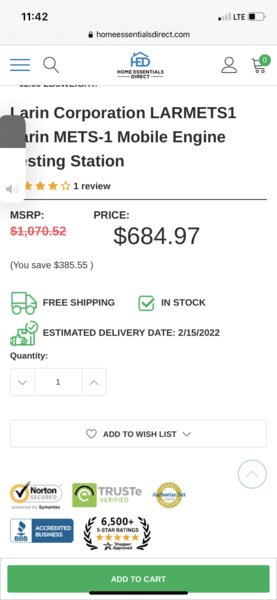

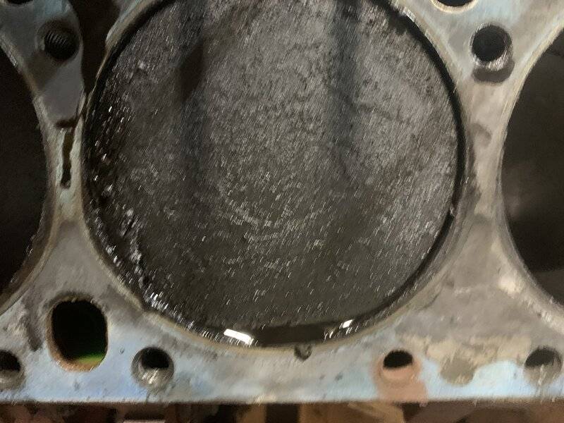

Got a engine test stand. Free shipping but I got fast shipping for only 30 dollars with shipping insurance.. y’all check this deal out at hone essentials. This 440 will have to be gone through because it’s got to much oil sludge and shrapnel so far.
We are going to a different machine shop outside of Tennessee that can get this stuff done in 2 weeks or so.

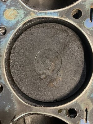

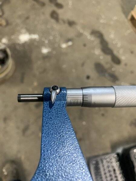

it doesn’t need boring I don’t believe because the 5 thousands clearance and pistons are firm and not loose.
I believe I got the mic off.

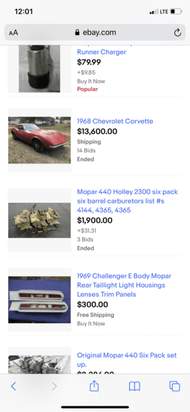

eBay six pack with a non original intake you can tell by it’s had CH on the intake right by the idle solenoid. That corvette wish I had the money I’d had bought that to add to my bundle system one day.
another six pack nos pack of non originals that sat for 30 years 1900 in bids.

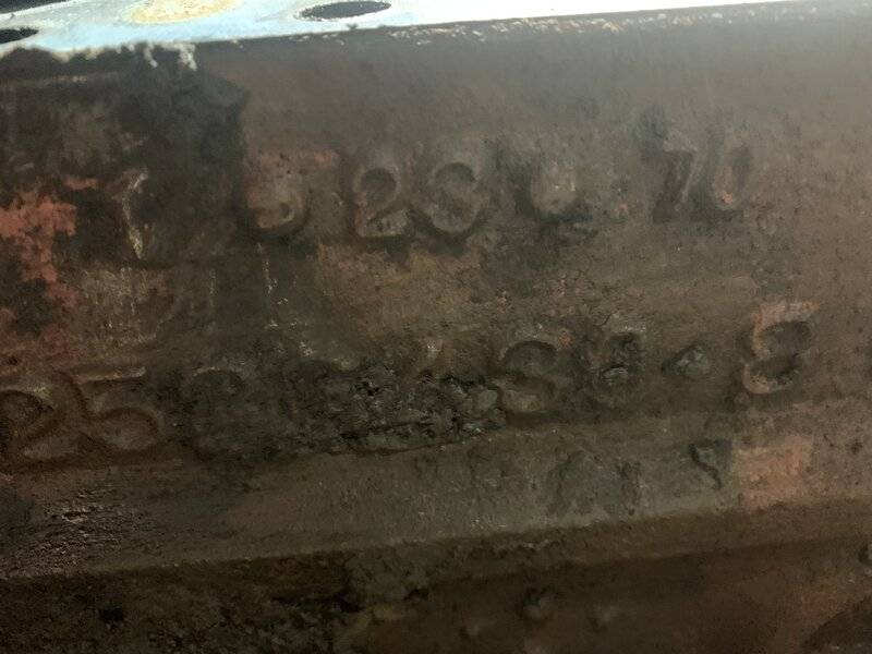

Stamp date codes.. Weird heads not even close to matching. 906 1970 on the 69 day I believe. And 1971 of the 12 day. With a g440 block but stamped early 1970.
