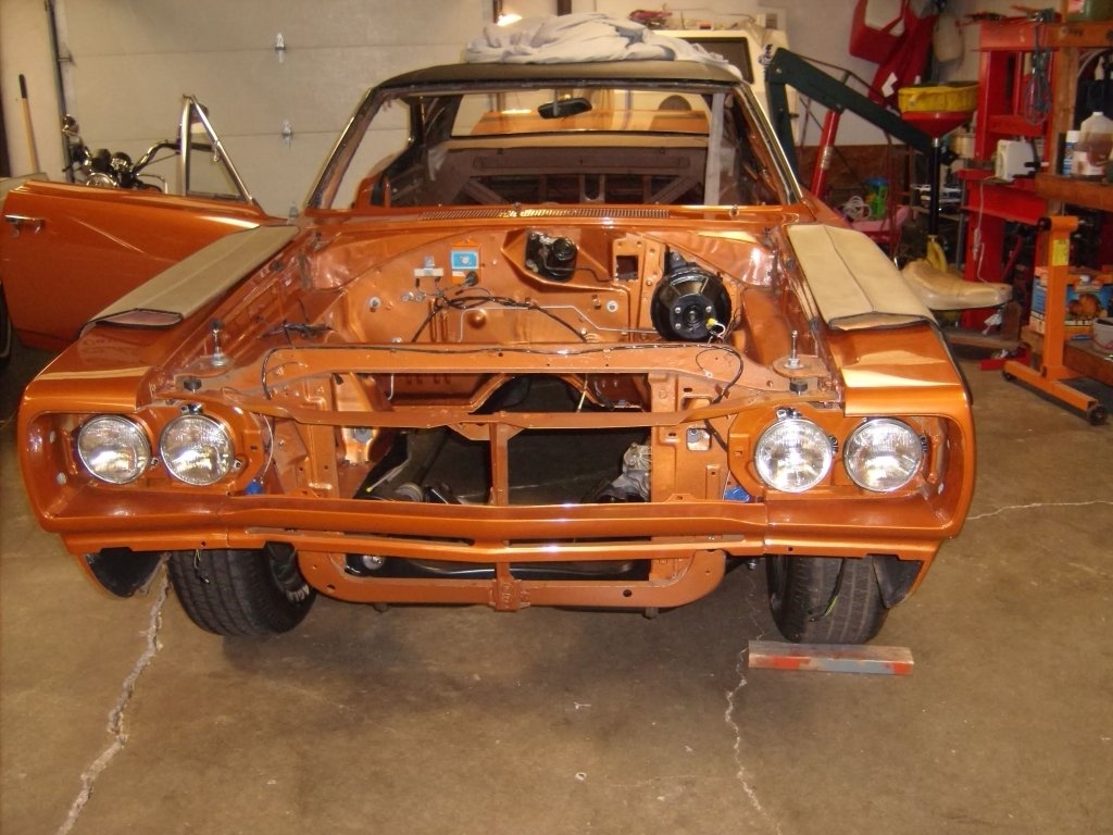

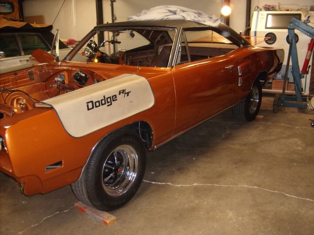

Here are some current pics of my project 8 months in. This car was a real turd when I took it on. It was nicely painted but poorly running. Turns out the car is from the coastal area of Texas and had the surface corrosion to prove it. We spent most of the summer repairing the front frame rails which were so poorly repaired by the former owner. They took .187 thick plate and crammed it in behind the rust and tried to weld it in. Then put bondo over it. The trunk floor was also replaced during this period as well as all the suspension components were blasted and coated with the appropriate finish.

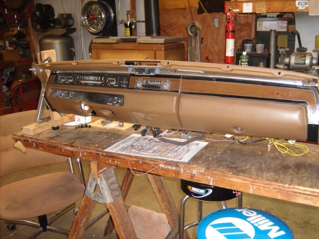

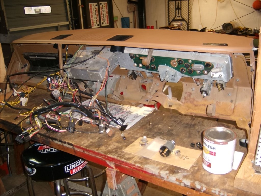

I'm doing the dash myself. The harness was in good shape but the previous guy who put it in didn't know how it was routed. I sure could use a reference picture to illustrate the correct routing.
I'm doing the dash myself. The harness was in good shape but the previous guy who put it in didn't know how it was routed. I sure could use a reference picture to illustrate the correct routing. View attachment 384783
I am about to refresh mine. It is currently sitting in a wood frame I built for it in the garage. It has not been touched since it left the factory other than me removing it from the car last fall. I can take a bunch of photos tomorrow when I am working out there. Mine is a 68 500 with AC.

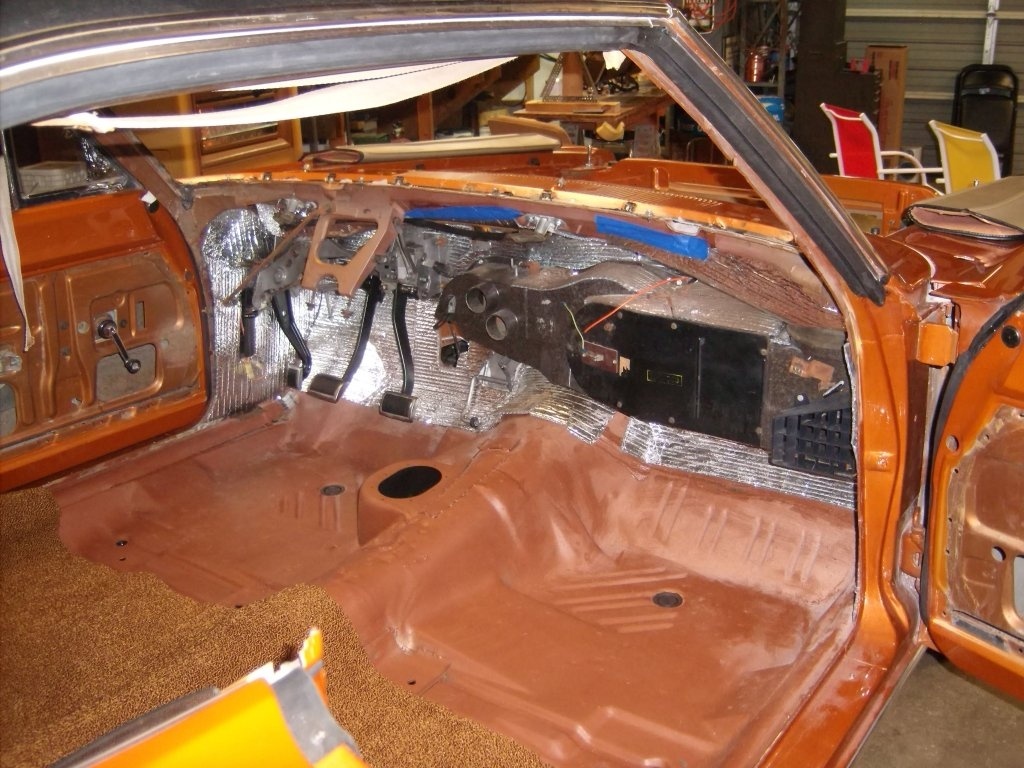

What adhesive did you use to hold the thermal barrier in place? Beautiful car by the way.
