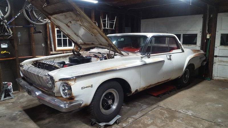

Project Larry - 62 Dart 440
Installed and I like it a lot.

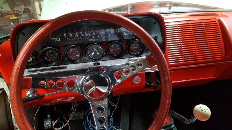

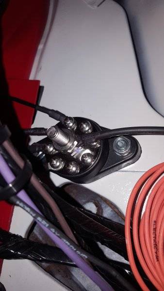

Made a small harness for the gauges, power, grounds, grounded the housing, etc., and a ground hub that will have a ground wire directly to the battery.
AAW kit uses a GM headlight switch, had to trim the original screw in aluminum spacer as the threads were too long.
Also had to use original rod, but round the end off about 1/4 inch to match the supplied GM one or you can't remove without taking switch apart.

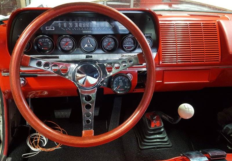

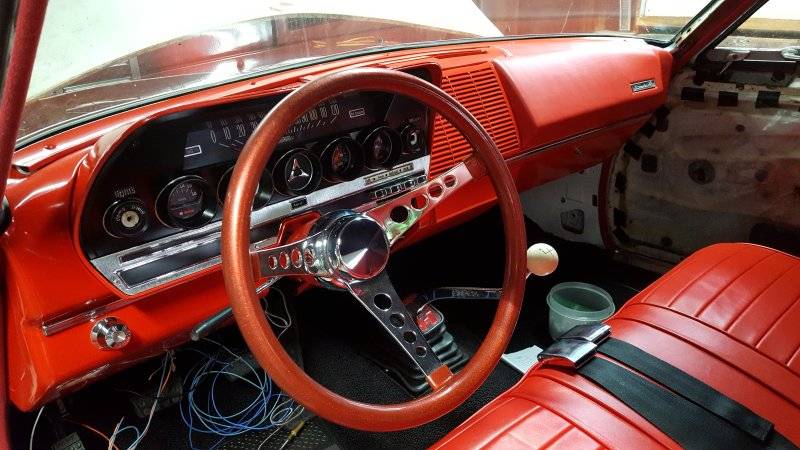

Tach installed, didn't want to destroy a freshly painted column, so I put multiple wiring heat shrink tubes over the hose clamp, no scratching, looks great.

Ground hub under dash, same one next to battery, connected by cable.

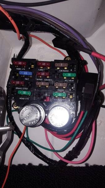

AAW fuse box, nice.

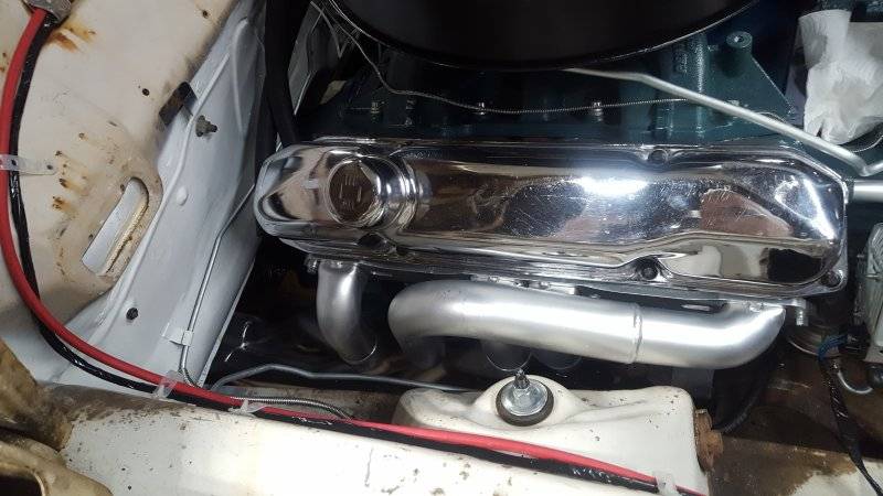

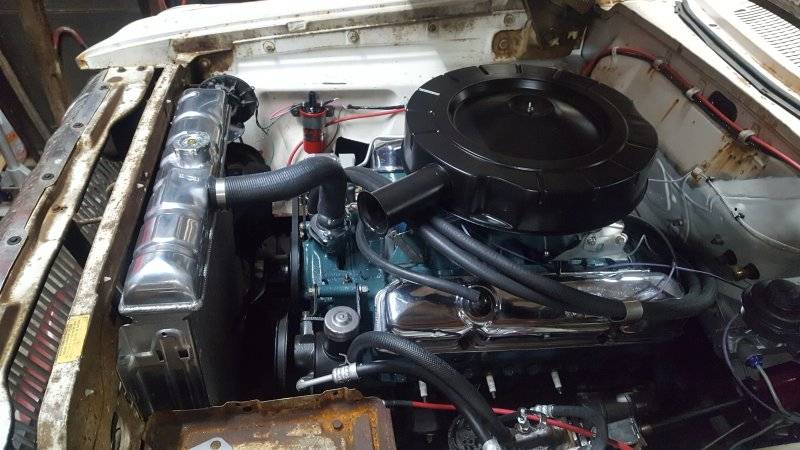

Alternator installed/wired, I put the coil on the inner fender on my other car, upright mounting, close to distributor, wiring/coil away from heat, wiring off engine.
Power steering installed, need to fill/bleed.
Radiator/hoses installed, bottom hose and upper left off on one end to flush engine once fired.
Made headlight harness from scratch, first time headlights have been installed in years, Lary has his face back, and what a beautifully ugly face it is.

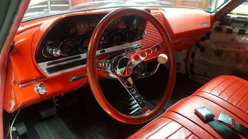

That's been mandatory for any old ride I wind up with - gotta be a 4 speed!
Too much work for me to convert, and money.... but would open my options to get away from this pushbutton trans :) just don't want some boy racer floor shifter for a auto..
Other option is to put bucket seats in and use console and shifter from '64-'65 B-body. You would also have to use floor brackets, cables and valve body from console donor car. These are different than push button pieces.

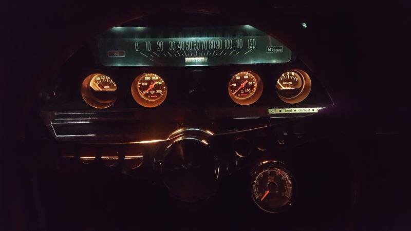

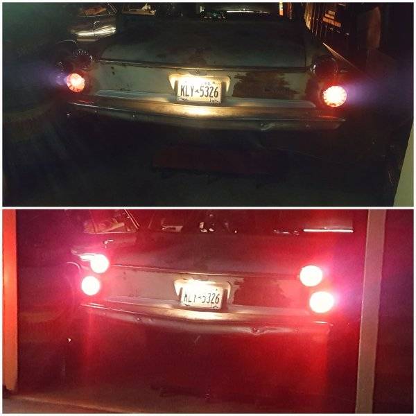

Lights work, and are darn bright for just regular headlights.
Removed reverse lights and they became the 'third' brake light from the AAW harness.

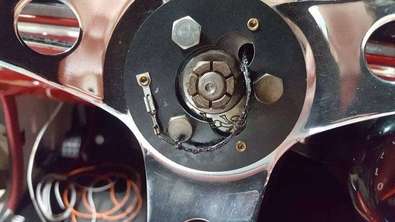

What happens when you wire the horn relay incorrectly by swapping the ground and green wires?
Well, you hit the horn button late at night expecting a beep or some old horn trying to come to life, instead you get flames from behind the horn button.
Removed column harness, checked everything, no other wires damaged.
Unsettling to say the least.

Horn back together and no fire and brimstone.

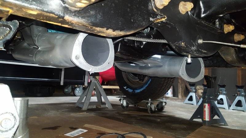

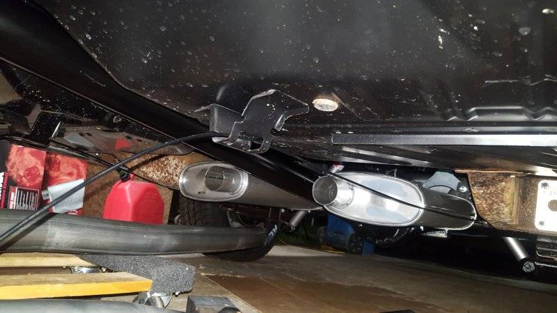

Rear exhaust pipes loosely installed.

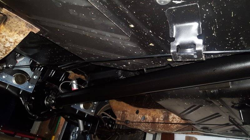

Step 1, install the tailpipe hangers.
May need to drill a hole for the passenger side, or drill new holes on both sides.
Step 2, install the muffler hangers, which have clamps inside. Slide tailpipes over axle through internal clamps. Then mufflers slide into the tailpipes, then clamp together.
I noticed the driver's side framerail has the tailpipe hanger hole, and the passenger side had one as well, but farther forward, huh?
Looking at the tailpipes, the welded on tabs for the hangers are in fact in different locations to line up with the factory holes.
Who knew? Apparently TTI.
Not sure why the passenger side hole is forward. Both sides have the hole with the rectangular slot below.
Passenger side intermediate pipe does not fit.
It pulls the muffler into the rear and driveshaft.
If I place it were it should be, the H pipe does not connect, and it misses the header completely, to the right.
Tried collectors on both sides, but they are stamped L and R, and fit best that way.
Tailpipes & mufflers fit perfect.

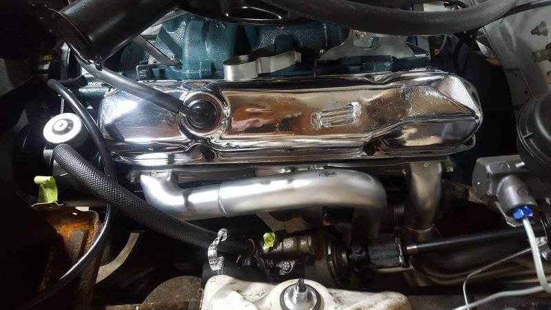

Passenger header was a be-atch. Took the bolts out of the driver engine mount, the bolt off the trans mount, removed the passenger mount entirely, it finally went in from the top.
Supposed to be from the bottom, but the car was way up in the air with the engine jacked up and it was a no go.
I heard a giant pop, trans mount exploded.
Driver side header went in from bottom no problem, even with the starter, steering, engine mount, dipstick, everything there except the Z bar.
I measured everything per the instructions and the engine is exactly were it should be, no shims needed.
The only odd thing, the difference between center of crank to one side and the other is listed as 3".
Measured ten times, 2 tape measures, 1 laser measure, difference is 4".
No amount of shims will make it 3".
Either they have it wrong, or 62 is an oddball.
Everything loose, that friggin passenger pipe just doesn't fit, the header fits perfect, there's no room for it to move, and moving the header wouldn't solve the issue of the pipe into the driveshaft/rear.

Driver side pipe bolts in no problem.
Passenger side will need to be cut and angled. I'll post a pic.
I'd like to know the reason before I cut it, as the 2 pipes are basically mirror images, but it may just be because it's a 62.
