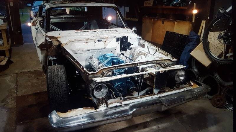

I got the trans back in and had to modify the header collectors, cut/weld/fit/etc.
Later that night, I realized I put the pipes on upside down.
I couldn't stop laughing at myself, not even upset.
So I spent the next weekend putting the exhaust together, again.

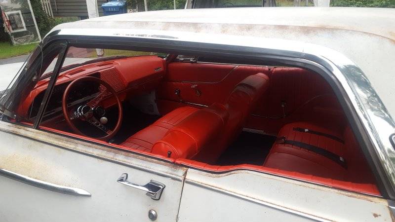

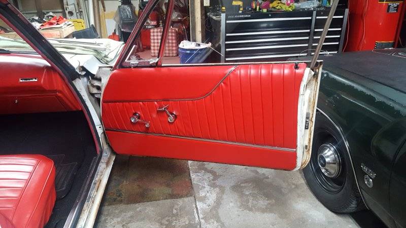

Finished fabbing/installing the door panels too, what a difference.

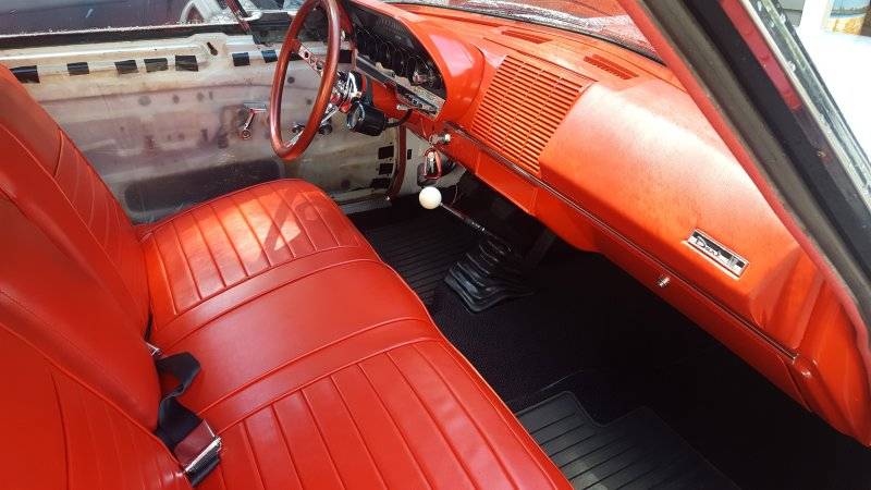

I swapped out the mile long b-body Hurst knuckle buster handle, especially in reverse on the heater controls, for a 68 a-body handle.
It's near perfect, could use an extra inch, so I think a trip to the hardware store will solve that, threaded sleeve/rod.
Anyone else use a different handle that works well?
