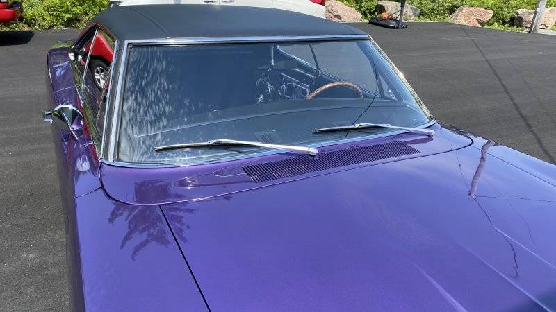

You did a great job on the roof vinyl. Did my head liner by myself and will say it can be done just like vinyl top. I will say that my hand's and finger's hurt like hell the next day. Good job!!!!! Blue.
oh man you couldn’t be more right about the fingers! Partly separated my finger nail on one of my fingers. So sore the next day, I didn’t do much of anything - I just chalked it up to getting old :-)

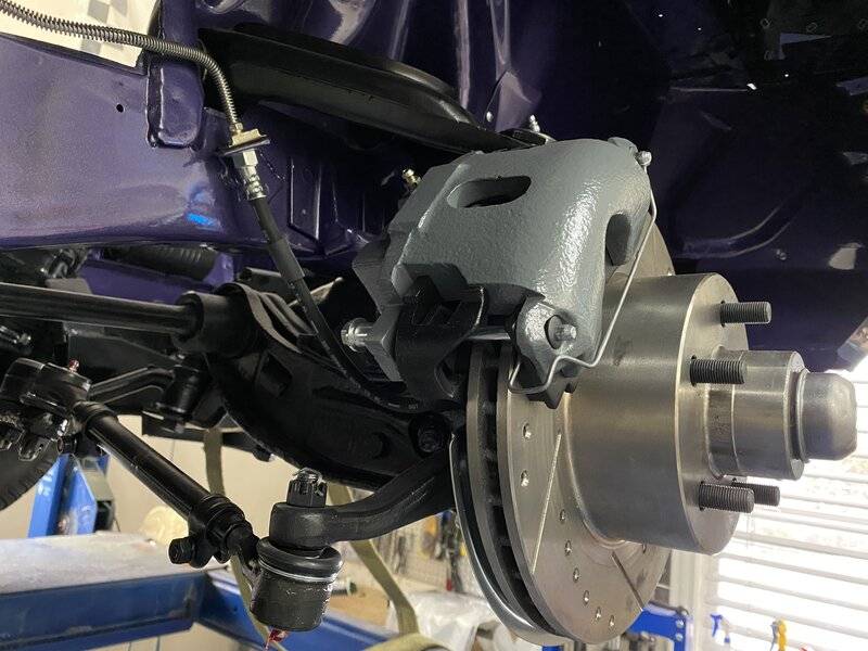

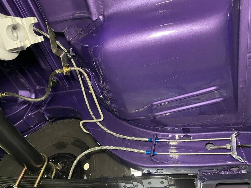

Another milestone met today on the journey to completion, brake system is now fully operational. All new pre-bent stainless brake and fuel lines from inline tube, including booster and master cylinder setup.
Hydraulic clutch reservoir for the tremec is installed, made a bracket to mount it off the the master cylinder.

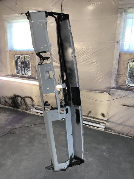

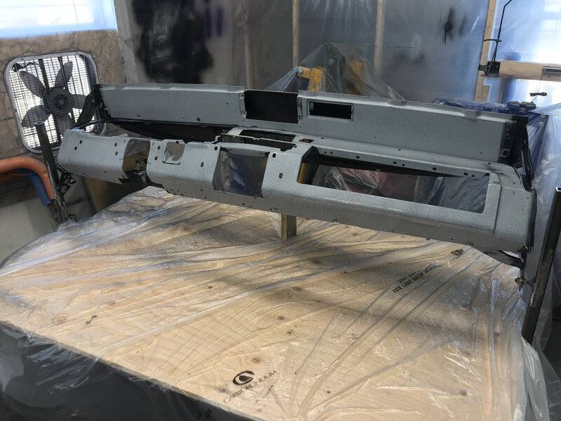

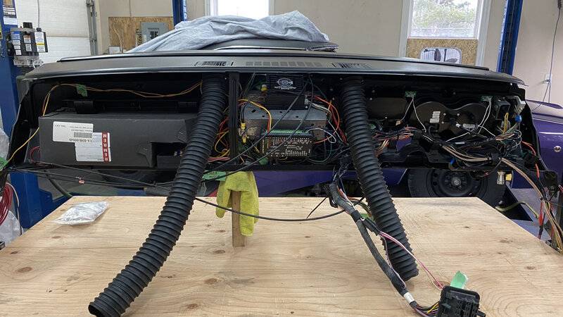

Dash is finally all done and the new Dakota Digital RTX gauges are installed - I love them! Dash was blasted, epoxy primed, textured with 3M texture paint and SEM landau black on everything.

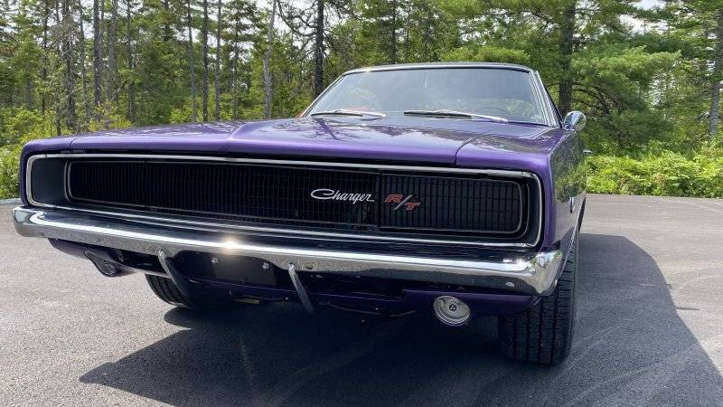

New AMD windshield installed this weekend, finished polishing all the stainless trim for the car, got all the windows installed, power windows working. Need final adjustment on the passenger side quarter window, it’s being stubborn. New shoes are on now too! Still waiting on new legendary upholstery and door cards, won’t see them until October it looks like. After that, it’ll be time to build the 440 over the winter and have it running for next spring. Had it outside for a sunbath today, first time since last fall.
Shoes:
rear: 295/15/50 on 15x10 (5.25 backspace)
front: 245/15/60 on 15x8 (3.8 backspace)
