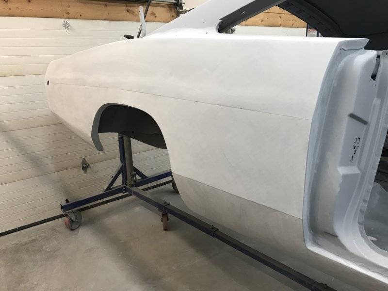

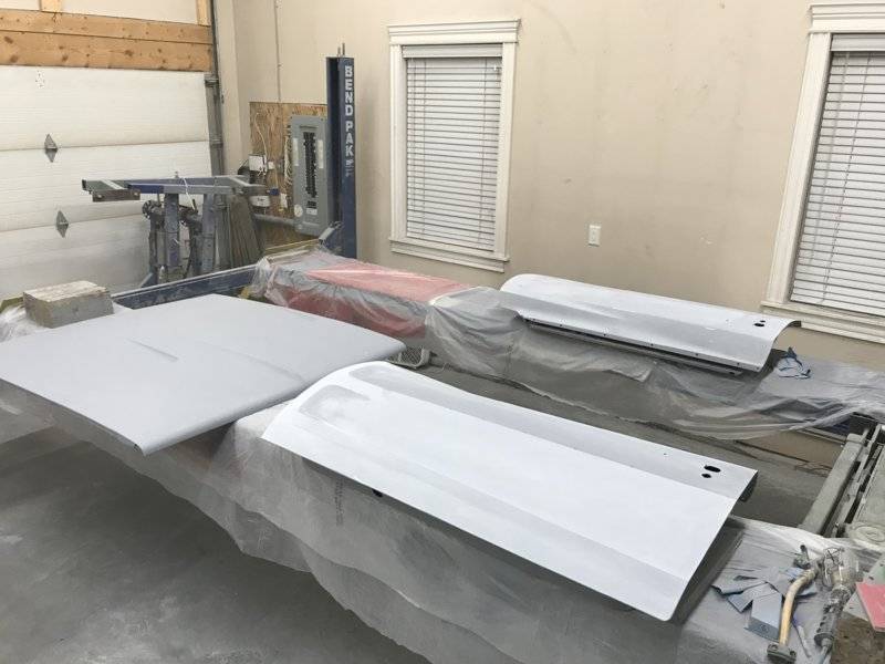

    Work continues... not taking a lot of photos these days as I work through the blocking sanding stage. Think I’m still on track for paint in october.
    Panels are coming off the car for the final sanding/prep. Chassis goes back on the rotisserie this weekend for the last time in preparation for paint.

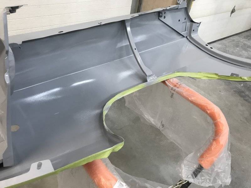

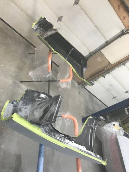

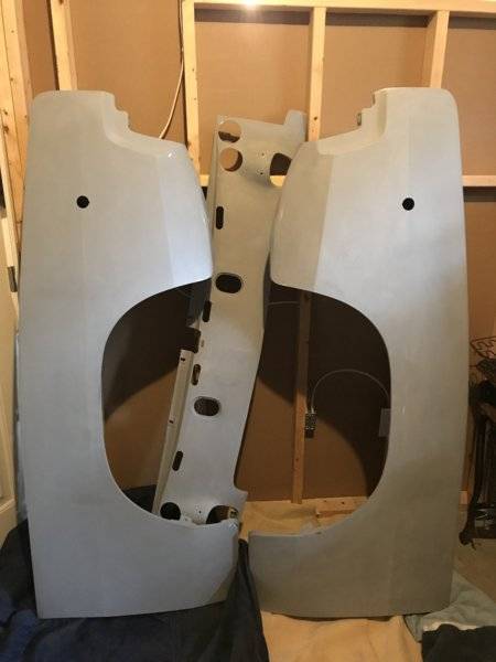

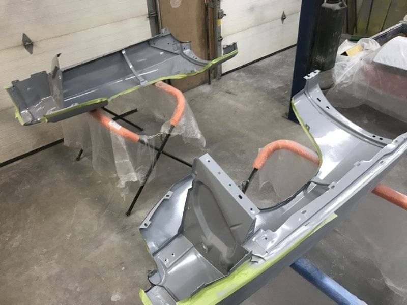

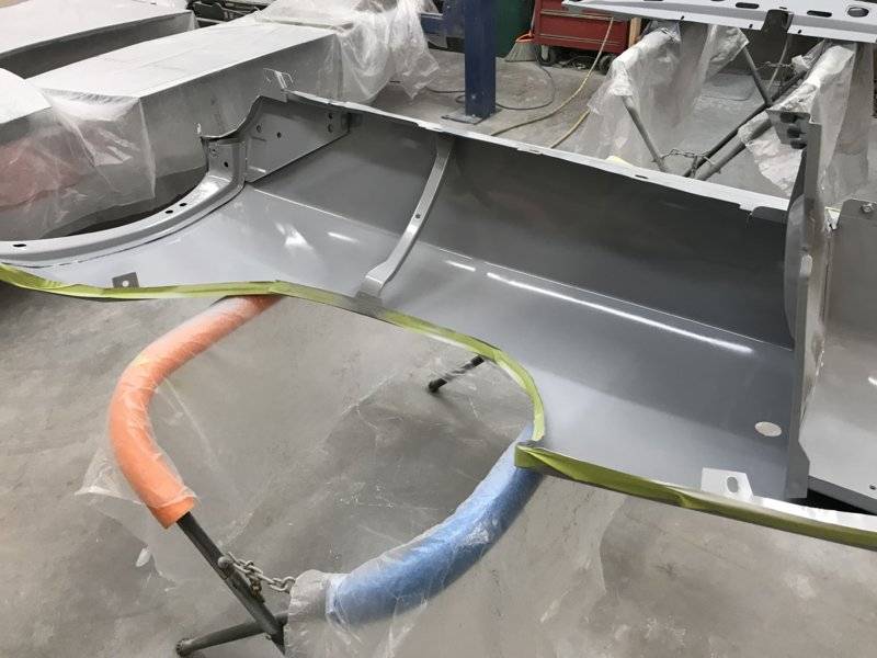

      Fenders are finished being blocked and just scuffed and laid down two coats of epoxy primer on the inside. They are ready for colour.
      E3DDCB88-96CB-4D94-BD57-30B117A394E7.jpeg BA195EA3-4DD4-4E47-9F4F-027495452AD1.jpeg B7E97501-5C50-4D99-849A-6FCA9F0D103E.jpeg 6108A711-8361-4C0C-BA1D-F12033D779D8.jpeg image.jpg

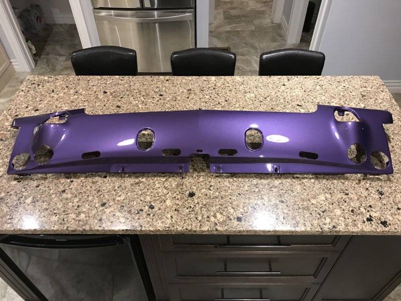

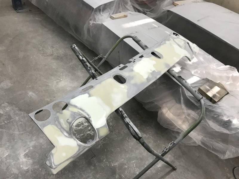

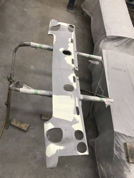

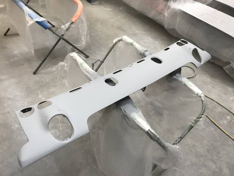

        Front valence needed some metal repair and straightening and then body work. All blocked and ready for paint now.
        F0D14BB4-1112-4F08-8455-C48C44A2B0DF.jpeg 934B4868-2961-4581-B313-46927AF77F66.jpeg E8005F4A-B80A-490A-80CE-2543549189F3.jpeg

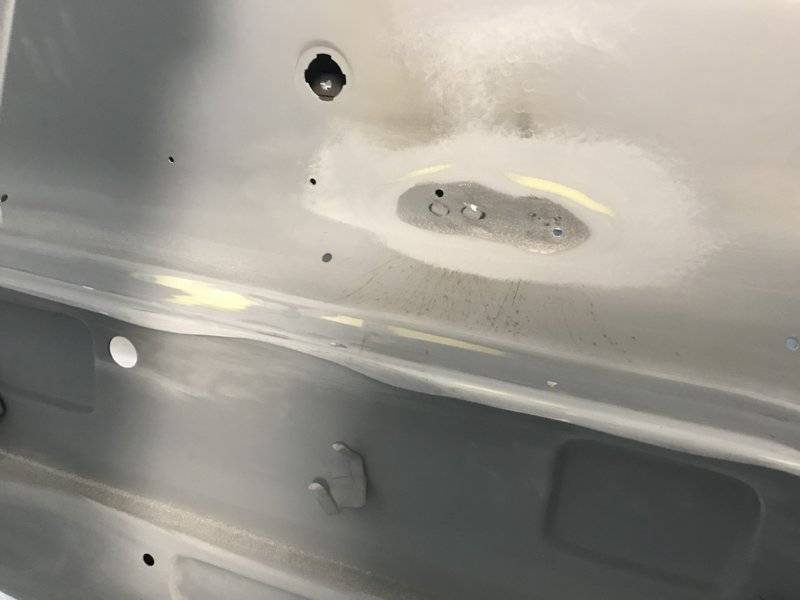

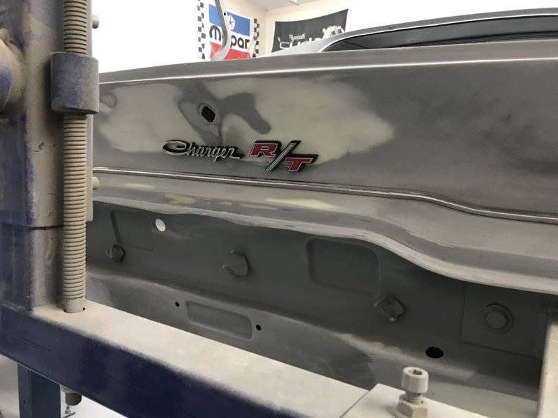

            Getting down to the end of body work, finally got around to drilling new and filling old holes for the R/T emblem on the rear tail panel.
            6092E4D6-DE82-47DC-A6A0-E8FE96269CF6.jpeg 8D4DAD5E-53A6-4058-BBB4-7E0CACC66200.jpeg

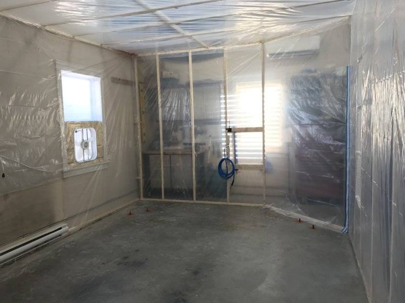

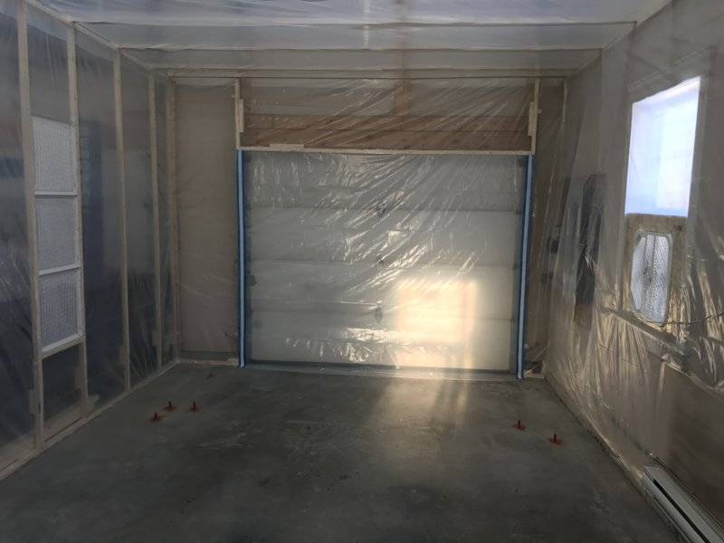

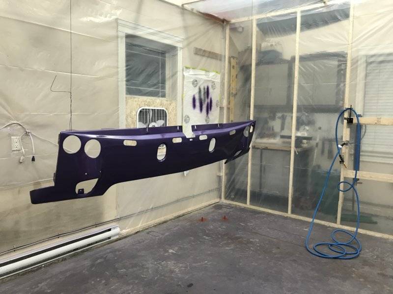

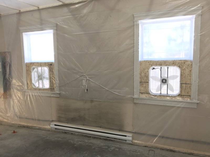

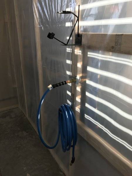

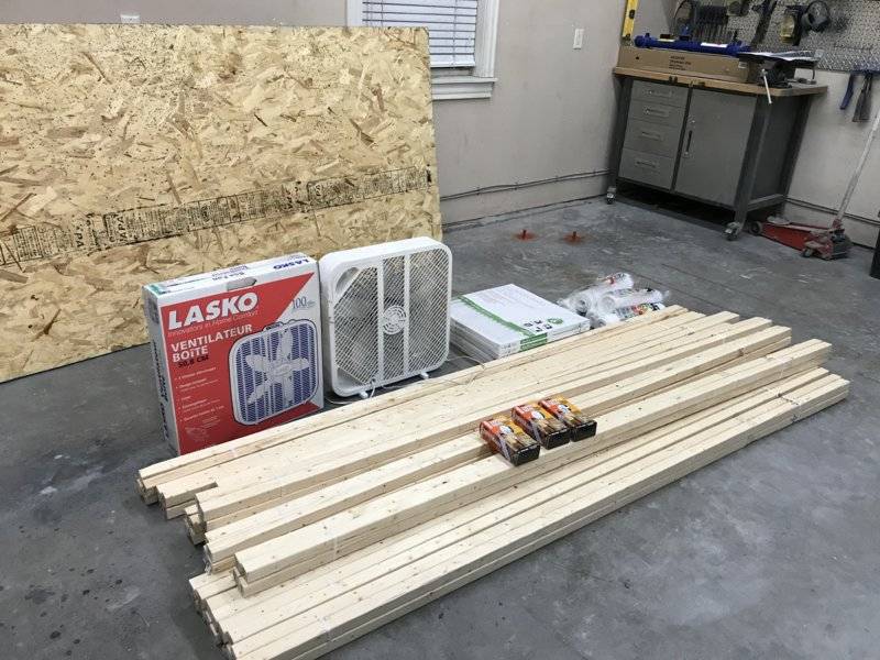

                Paint booth is done. Thought maybe I would need to add some lights inside but I think it will be enough; there is a lot of natural light from the windows and a lot of light coming through from the rest of the garage. Going to spray a test piece this weekend and that will help determine if more lighting is necessary.
                Booth is 12.5 feet wide, 21ft long and 9.5ft high. 3.5mil plastic stapled to 2x2 studs. Zipper at the front for access while painting to mix, etc. To zippers at the back for bringing the car in and out. Need to grab a thermometer today and mount inside so I can monitor heat inside the booth.
                Extra air dryer and filter added just outside the paint booth in addition to the setup for the main garage.
                Total cost for the booth, approx $400.

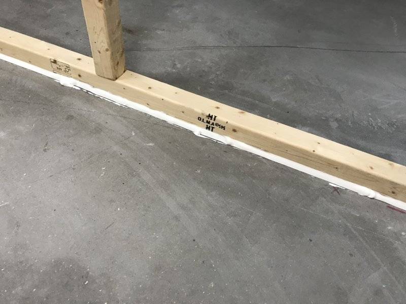

                Base is siliconed to the floor for a seal. All joints are sealed with clear packing tape. I think it’s pretty air tight. When both fans are going the plastic on the walls visibly sucks in, so good negative pressure being created.

                  Update posted! Let me know if want any more info.
                  • Like Like x 1
                  • Jeff Brundage
                    Jeff Brundage FBBO Gold Member FBBO Gold Member
                    Messages:
                    137
                    Likes Received:
                    76
                    Joined:
                    Aug 12, 2018
                    Location:
                    Eastern Canada
                    Local Time:
                    8:54 AM
                    Great setup,but the silicone may cause some issues with the paint fisheyes. Its a good idea to spray test panels, it should show up then if it’s going to be a problem. The next couple of days is decent weather for spraying, or as good as it gets this time of year. It sucks not having heated makeup air in the colder months. Good looking project. Hope to see it on the road next summer.

                    Jeffs rite hope you wait till that silicone really sets up a shop l worked in had a car ruined cause some one spayed some silicone out in the shop and it got into the paint booth had to resand car and repaint You'd be surprised how far silicon travels in a shop so do a couple test pieces be for you paint. Ya mite want to cover the silicone with a water base paint before you start painting auto paint. Just my opion.

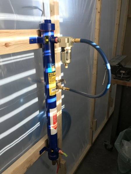

                    Thanks for the heads up in silicone guys - I had not come across that problem before. I laid down some paint over the weekend to test things out and I think all is okay.
                    E7A2705A-3B01-452D-8962-B9C18DB75C65.jpeg 53D2A17A-B662-471D-B778-2D9DB24B161D.jpeg 8AFB0B0E-7E1B-4546-9F58-24EB8D9F19D5.jpeg

                      What is the long blue cylinder on the wall for?
                      I like the booth, thanks for posting
                    • Twalker
                      Twalker Well-Known Member
                      Messages:
                      163
                      Likes Received:
                      296
                      Joined:
                      Jul 15, 2017
                      Location:
                      Nova Scotia, Canada
                      Local Time:
                      8:54 AM
                      Hey Don, the long blue cylinder is 2nd in line air dryer; just extra insurance.

                      Where is the 1st one, by the compressor?
                    • Twalker
                      Messages:
                      163
                      Likes Received:
                      296
                      Joined:
                      Jul 15, 2017
                      Location:
                      Nova Scotia, Canada
                      Local Time:
                      8:54 AM
                      yeah, for regular day to day use in the garage I have a dryer and a filter after about 25' of hose from my compressor - so my existing set up looks like this:
                      Compressor > 25ft house coiled up > dryer / filter combo > 50ft hose reel

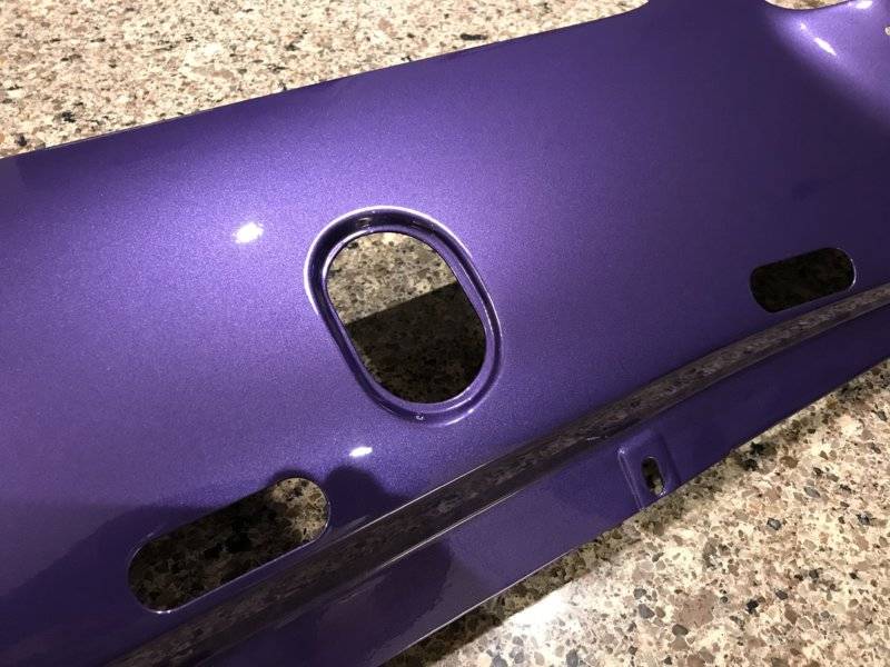

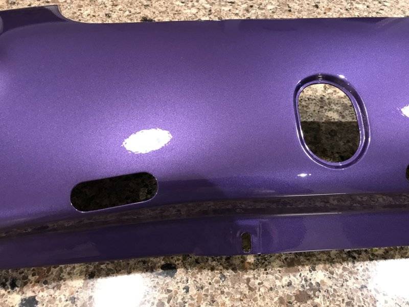

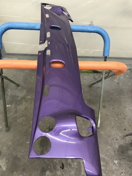

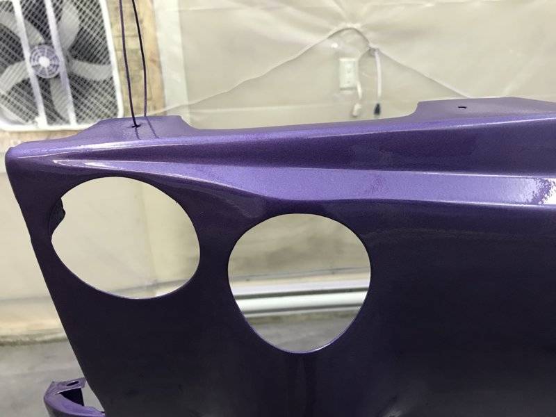

                      Change in plans! Was using a eurothane single stage for the first spray out. With the metallic in this plum crazy there is no way to really work with it to take out any peel or imperfections. Switched up to base clear and resprayed today; happier with the result and colour and with lots of clear applied I can work the surface the way I want. The chassis moves into the booth tomorrow for prep!!
                      9791F3AA-A252-4620-8B04-FB28686F1E90.jpeg 8C22E726-FB09-401A-95CA-8EEA6B8FFB48.jpeg 7B3FE145-9DE7-41C4-967A-3F2E9DE228F3.jpeg

                        The paint looks great! Just run some good duct tape over the silicon.
