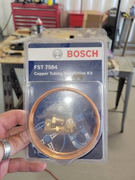

I think he meant nickel-copper like used in custom brake lines.
RGAZ
This stuff, which is meant to be run inside cars for oil pressure. Been using it on cars/trucks/boats for more than 40 yrs without a problem.
This stuff, which is meant to be run inside cars for oil pressure. Been using it on cars/trucks/boats for more than 40 yrs without a problem. View attachment 1350554
That looks good to me.
The reason I said that is that I used to use copper lines for coolant on cnc machines.
If the machine had a lot of chatter and vibration it would cause the copper line to crack.
I don’t think you will see it on high end race cars.

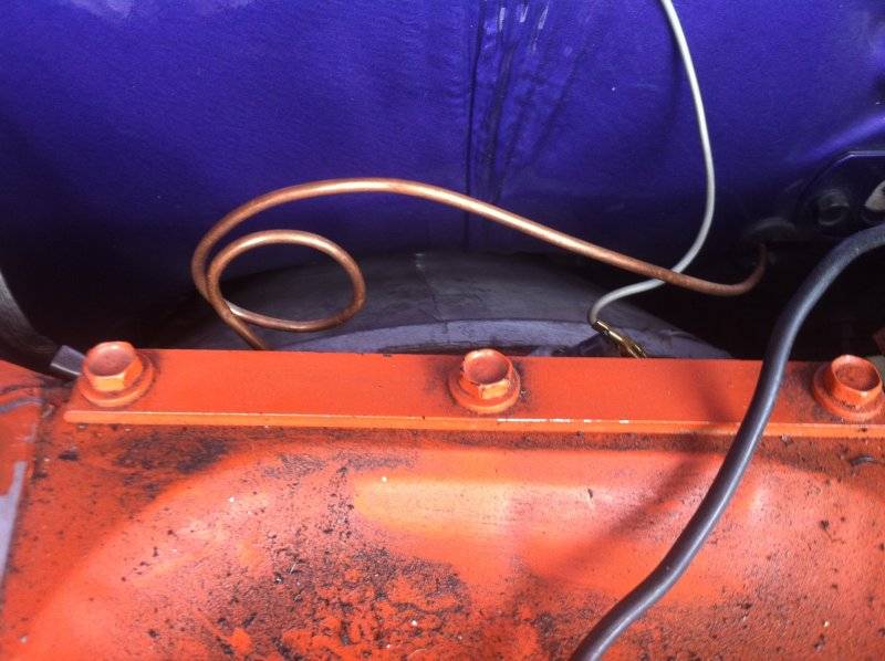

I've been using copper oil lines for years on my motors. Never seen a problem with lines breaking or leaking on my cars or friends, plastic lines, yes. Just make sure you leave a little coil of line at the motor and at the gauge.
