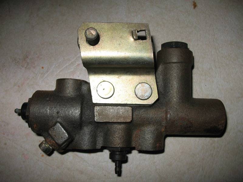

I have this one sitting in the garage collecting dust. Never been on a car. PM me if interested.
What you have is a Combination valve. Center section is the distribution block with warning indicator switch. L shaped is the proportioning valve for the rear brakes on cars with disc on front. V shape at other side is metering valve for the front disc.
Drum drum do not have proportioning valves, just the brass distribution block with warning. Weatherhead made them.

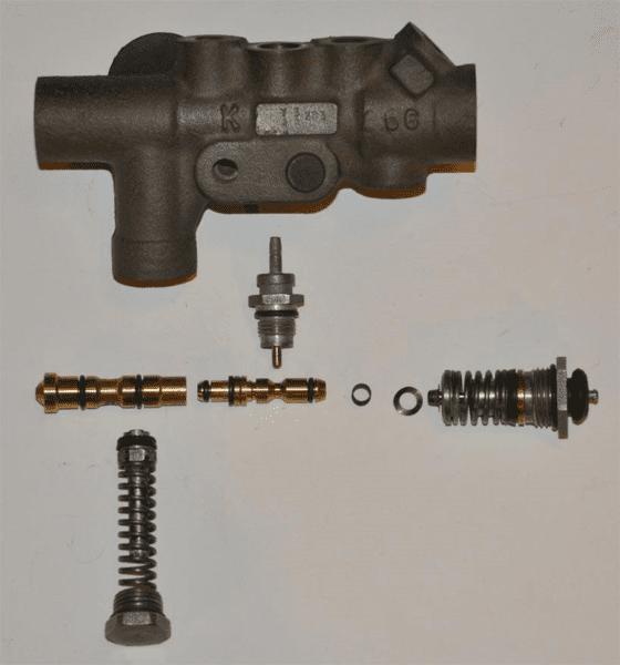

If doing yourself as posted MCR sells the kit, same place Brake Warehouse gets the kit. I do think one of the major manufactures on West Coast also has tech show that can rebuild some of the original ones, but that was years ago with leftover parts. The combination valve is the easier to work on. Those 70 meter valves cannot be disassembled without special socket since the assembly is peened in to crush into the threads. But the combination valve comes apart easy.
