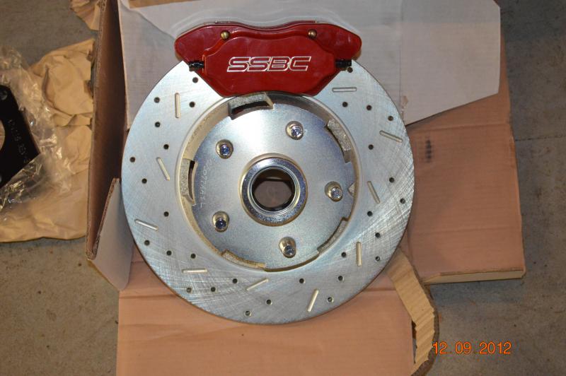

I will be starting the SSBC brake conversin on my 69 GTX in the next two weeks.
My GTX has only drum brakes so the prop valve should be changed or have an adjustable valve installed inline. I am not interested in leaving the drum prop valve on and adding the adjustable one in there.

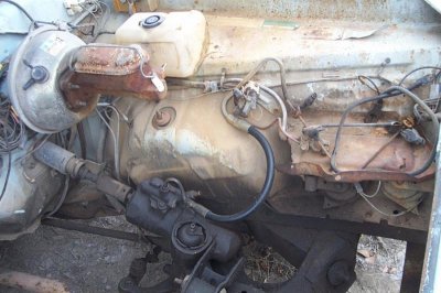

Disc or drum? Drum used brass but I though the disc A-body went to the cast valve like the B/E's. I have a 73A in the yard but can't see the valve in my pic so I'll have to go look.
There were all disc brake cars because I got the spindles also. I guess they must have used both but the yard I went to all of the disc brake 73-76 a bodies had brass valves
Naw you maybe right. I've been more of a B/E guy over the years. Been a while but thought the last set I pulled have the iron valve.
It sure was nice to use the a-body valve because it was a direct bolt-in with a b-body brake lines even bolts to the frame in the same place.

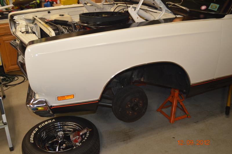

i got the prop valve off today, that was brass and i will be making yet another purchase. I will replace the front lines that go from the prop valve to the frames and from the master to the prop valve.
After 40 plus years. I had some time to get them off.
Some got rounded off even using the line wrenches and others were marred from previous owner's work. PB Blaster helped a lot to free up some of the fittings. The master Cyl came from InlineTube, and i forgot to get the adjustable brake pedal rod.
That spiral armor protection was pretty filled with dirt and junk.
