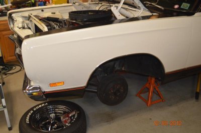

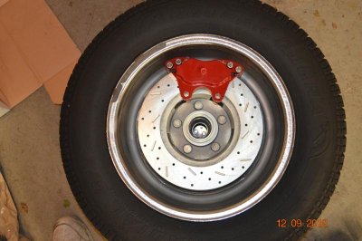

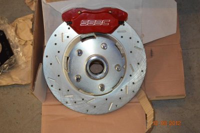

I will be starting the SSBC brake conversin on my 69 GTX in the next two weeks.
My GTX has only drum brakes so the prop valve should be changed or have an adjustable valve installed inline. I am not interested in leaving the drum prop valve on and adding the adjustable one in there.
