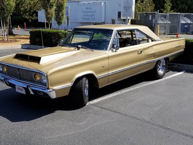

I'm working on a 67 coronet.
You haven’t mentioned what car you have and how it was factory equipped which would help you get specific answers. Regardless, you still need a disc brake proportioning valve. Dr diff sells them for $85. Or you can try to find one out of a disc brake equipped 73-76 mopar A body.
67 coronet. It was originally a 4 wheel drum brake car. Now has disc up front drums rear. Manual brakes.
