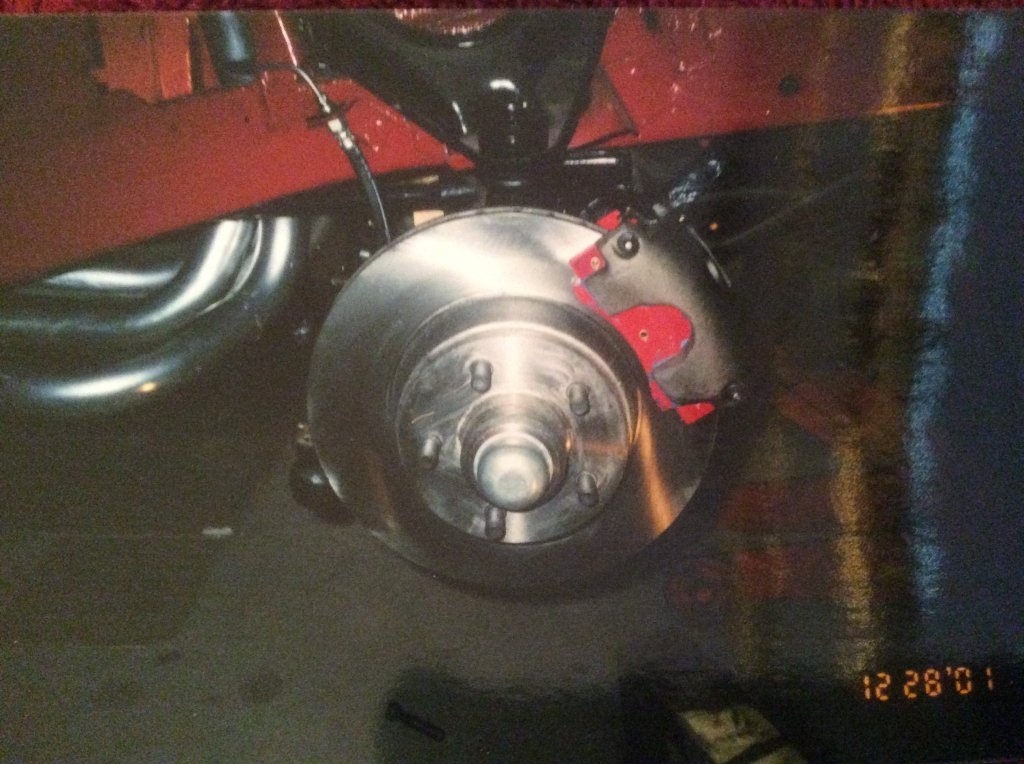

Yes CO2 is another option. The wheel IMO wouldn't shrink much because the metal is thinner. Maybe a little heat from a propane torch just before pressing it off? I'll post a pick of my rotor bought in 2001 brand ??
Yes CO2 is another option. The wheel IMO would shrink much because the metal is thinner. Maybe a little heat from a propane torch just befpre pressing it off? I'll post a pick of my rotor bought in 2001 brand ??View attachment 399972

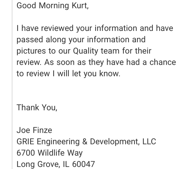

New update - Joe at Bendix called me today. Not only are they going to cover the return back, their entire R&D department is on it right now, and want to inspect the rotors on their return. Couldn't have asked for nicer people too - not only have they read this entire thread, Joe even did some research that led to a similar discussion on the Slant Six forum.
Now that's enthusiast-level service right there!
Joe also asked me if I had any factory documents that indicate the hub center diameter on the Chrysler rims of the period - not so much for proof for the exchange, but for the engineering department to look at for reference. I'm going to look through the factory parts manuals, but I dare say I won't find it there. Any ideas?
