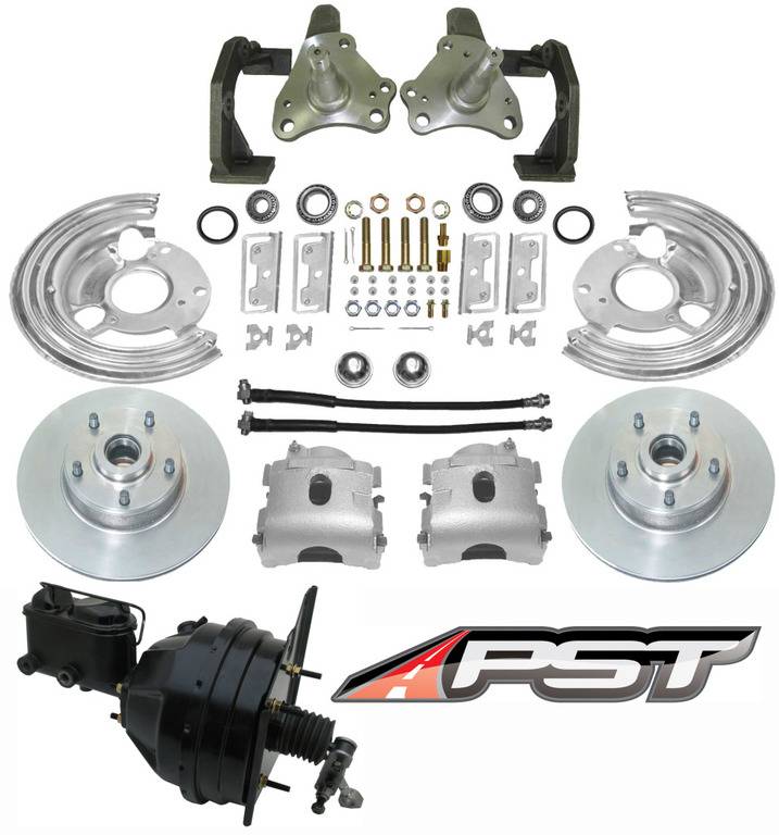

With a new year comes new products to keep your special Mopar on the road. Performance Suspension Technology now has the disc brake conversion kit for the purest of Mopar enthusiasts. Benefit from the stop power of disc brakes on your B or E bodies Mopar while retaining that vintage period correct look. The new kit features:
• Bendix trapezoidal nose that accepts the 4 point mount master cylinder.
• Cast Iron Bendix style Disc/Drum master cylinder
• Brake firewall reinforcement plate
• Proportioning valve
• Complete at the wheel disc brake conversion kit.
PST’s power brake booster looks, fits, and functions like the original Mopar B & E bodies boosters of the late 60’s and early 70’s. Until now there were only three options.
• Installing that ugly GM looking style booster under the hood of your Mopar
• Having yours rebuilt
• Buying a remanufactured booster with an expensive core charge
For information call 1-800-247-2288 or visit www.p-s-t.com.
Kit Price $1059
