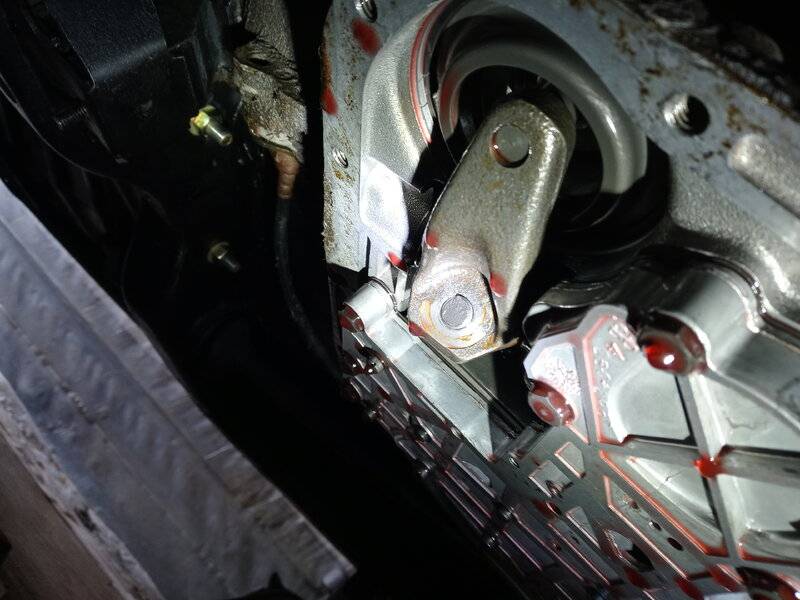

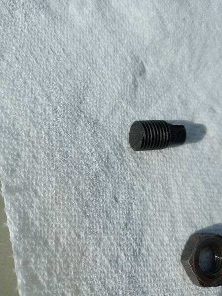

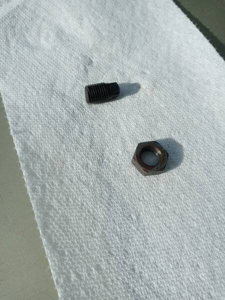

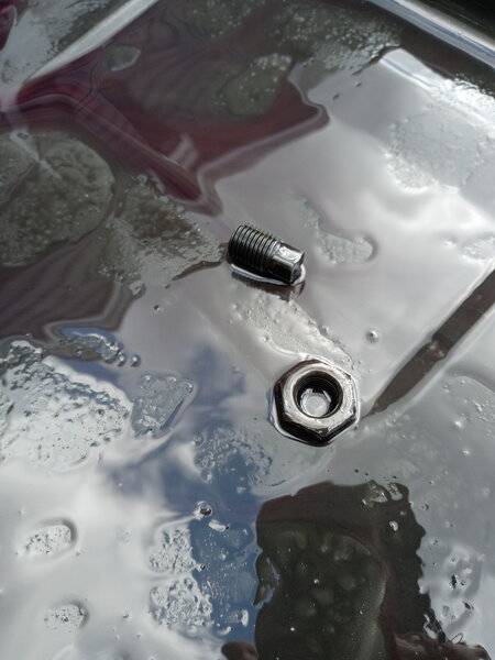

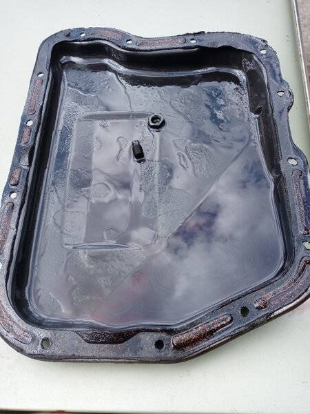

Looks like a sheared off bolt and nut. The transmission was shifting fine. Any idea where those go?
I was expecting some metal shavings....not this!

Look at the bands.
..and while you're fixing that, replace the O ring on the pivot shaft so you're not leaking out the back of the case!
Looks like the end of the adjuster is still in place....that's why it is still shifting okay....?

Does the stud hold anything behind it? If I can remove the stud, is anything gonna fall inside the transmission? I might be able to use a reverse drill bit and back the broken stud out, make a new one from a grade 8 bolt and re-use the nut.
Maybe I'll just leave it. The car drove and shifted fine.
You should be able to undo the valve body and get up in there with a thin screw driver to pop the band strut out. Then you can turn the remainder of the band adjuster out.
