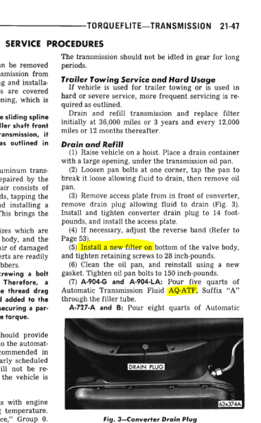

I've always been a little hesitant to take on an auto trans rebuild. Have done a few 3 and 4 spds though. With my memory and apparently cognitive lapses in my advanced age I would only try one while being supervised. With You Tube I could probably get through it though. The manual appears very detailed and helpful except for all the special tools they call out which were likely available from the tool crib at the dealerships. I now have a good size steel benchtop to spread out the parts. As long as no one moved anything out of place I might be able to add an auto trans to my resume.
Hopefully if I have to do one I can find a good torque converter although mine might be okay at 107,000 miles. I'm really curious now what the trans looks like with the pan off and why would someone put a deeper pan on unless that was the only one with a drain plug. Gotta wait about five more weeks before I can do the work due to my foot operation but I'll post what I find if it's noteworthy.
If as a kid you were the type that you tended to take things apart just to see how they worked and what was inside, an automatic rebuild is just like a grown up version of that. With a good service manual and Carl Munroe’s book on rebuilding Torqueflite (if you can find it) and help from some of the guys on here, it’s not too bad a chore. Although I’ll admit, some of the valve body hydraulics are still a bit of a mystery to me.
