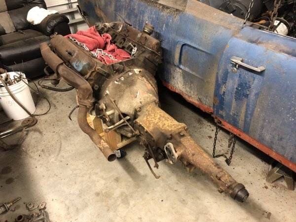

First, here is the rust bucket minus the engine and trans.

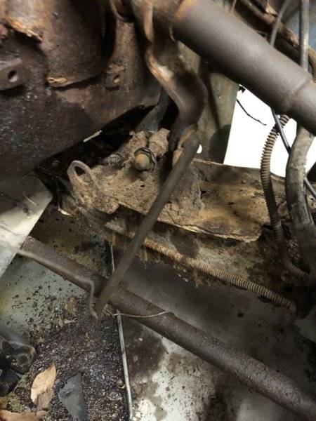

So, I thought everything would unbolt and bolt on from the 70 to the 69 until I found this:
It looks like I the z bar pivot, the part with the “ball”, was welded in over the frame.
Can I get this from somewhere, or do I have to salvage this one?
I am almost done removing parts. Can anyone suggest something I might miss before I haul the car away?
BTW, the pic might not show it, but that part overlaps the frame by about an inch.

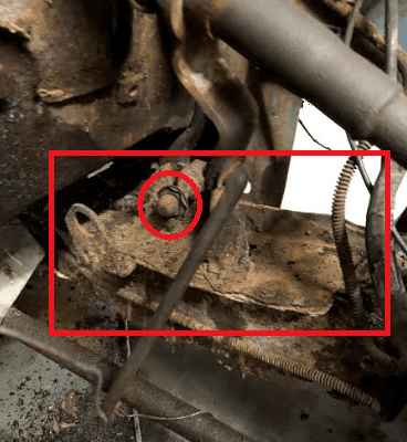

If you look at the picture, I have outlined the part in question. Fran gave me a link to an eBay part, but it does not look like the part I outlined. I am particularly interested in the "ball pivot" thing that I circled. Should I look for this part somewhere or try to salvage this one from the car? It looks solid, but I would not mind having a new one if it did not cost too much.
The mount doesn't look like the one I sent but lot of crud. That arm on column is that for steering wheel lock?

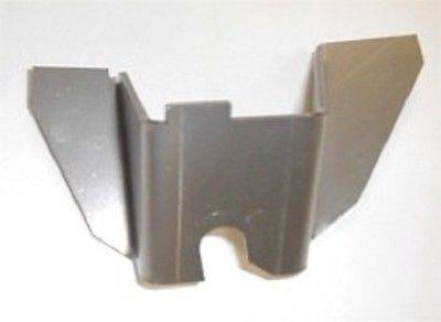

I would say yes to saving it. Since you are parting the car anyway, cut the chunk of framerail that holds it so you have a reference on how it goes back in. The part the Fran sent a link to is readily available....but I don't know that the other one is...and I'm not sure how the 70's have that mounted. If it were me, I would buy the pivot bracket that Fran sent a link to as it has a notch that helps locate it on the framerail (assuming the car the transmission does not have that already)
The ball pivot bolts in a slot on the frame rail. They're available New.

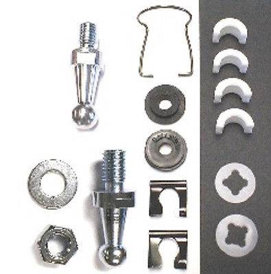

I am looking at a complete z bar rebuild kit from dante's. It looks like it includes everything except the bracket itself. I am asking them questions, but I am also going to ask for input from y'all. It looks like if I get the kit and the bracket mentioned by Fran at the beginning of this thread, then I should be all set.
eBay part: 1966-74 B-Body Ebody Challenger Cuda Clutch Pivot Shaft Z-Bar Service Kit Mopar
I do not think this is what I am looking for but cannot find anything else that resembles it???
