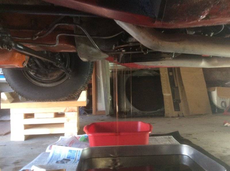

Have a 18"x24" Stainless pan. It was in a scrap hopper at work, pulled it out. It was a cover for machine base to cover electronics.

It's been said already but I always just:
-remove the front bolts completely
-unscrew the side bolts about halfway
-then loosen the rear bolts a little at a time, as you do the pan will open at the front and hang kinda cockeyed on the rear bolts..fluid will start dumping out the front, then as it empties just slowly remove the side, then rear bolts, lower it down and dump what remains in the pan. I like using the heavier latex gloves, I get more on my hands than on the ground..

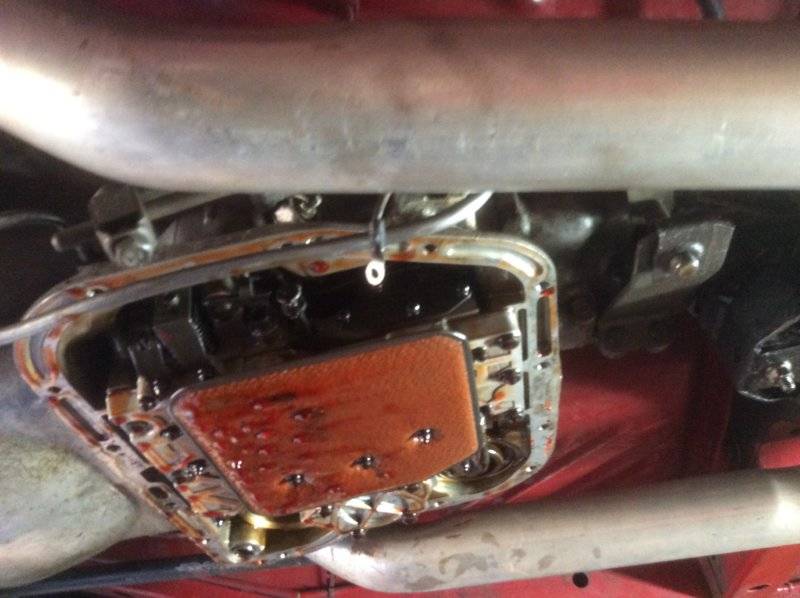

Thanks for the advice!! Dropping the pan was pretty clean. The most mess came when I put the socket I was using off to the side. No unexpected trash in the pan, Yee Haa. Bought a pan on ebay and it was unexpectedly heavy, thought it would be glorified aluminum foil.
