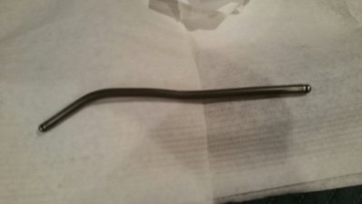

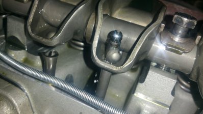

Need help, this is the second time this has happened, first on #1 cylinder, push rod through exhaust rocker (stamped steel) and cup came out of lifter, intake push rod is bent. Installed both new lifters and push rods, started ran break in for lifters went for a drive, got on it hit about 5000 rpm and back fired and heard a noise again, pulled valve cover and #3 push rod through rocker, cup out of lifter and broke ball off intake pushrod and bent it, not cool. Have stealth heads and mother thumper cam, engine builder told me push rods are from a big block Chevy. Any ideas it is a 65 413

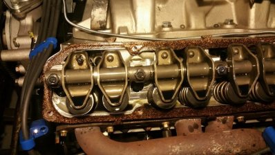

Lots of oil on the heads, the engine builder check the spring pressures, talked to him after first time he thought bad rocker and wasn't sure what caused the intake push rod to bend
I agree lack of oil due to discolored tip. Whats going on with the push rod next to it. Looks like the tip is gone and the pushrod is split. Id pull the distribtor and turn it over while manually turning the oil pump drive to make sure youre getting oil up top. Also check for coil bind on the other valves pushrods might be a little long? How do the valve tips look on the other valves. Is the rub mark on the center of the stem or is it on either the inner or outer edge of the valve

Tips look fine, discolor is probably from picture, yes intake broke the ball off and is bent. Checked coil bind and there is lots of room between coils, I'll have to look at top of valves but seemed OK, have a lot of oil on top of cylinder heads.

Common issue with used rockers when adding more spring pressure and lift. The ball of the pushrod is riding beyond its original travel creating a different wear pattern. This fatigues the rocker, breaking through. Then the pushrod catches in the hole and bends. How much spring pressure? Were the rockers used? How much lift? Are the pushrod ball ends the same diameter as the stock pushrods? I doubt if only one rocker would be missing oil with the stock set-up unless that feed hole in the shaft was plugged.

That pushrod to me looks like a classic too long of pushrod especially with hydraulic lifters. Higher rpms more oil pressure. Hence the lifter goes into for lack of terms a solid lifter and the pushrod either bends or blows the cup on the rocker arm. Like mentioned earlier check for proper preloading of lifter. It might behoove you to get a couple of checking pushrods to set lifter preload and once that is done compare the lengths of checking prods to existing prods and see what the difference is. Id pull out the lifters in question and take them apart to make sure the internals werent damaged as a result of bending the rods
