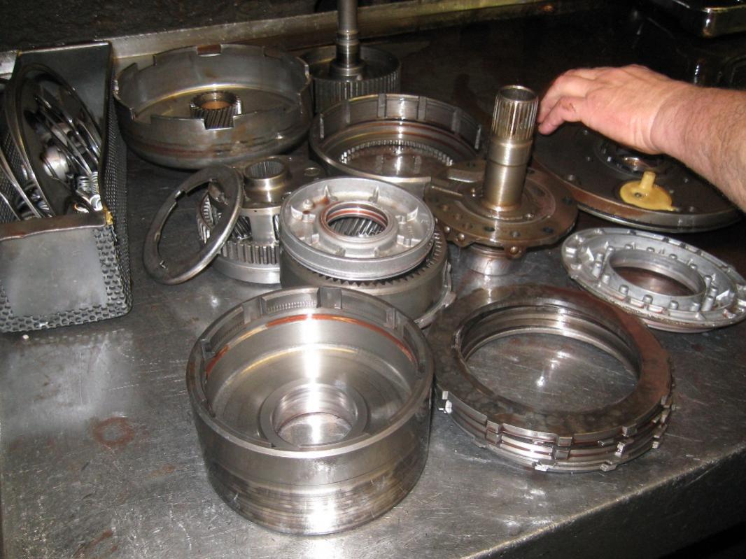

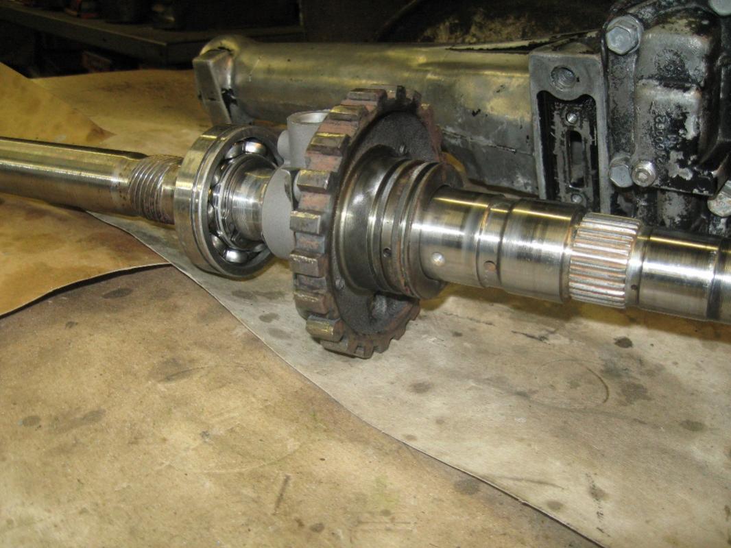

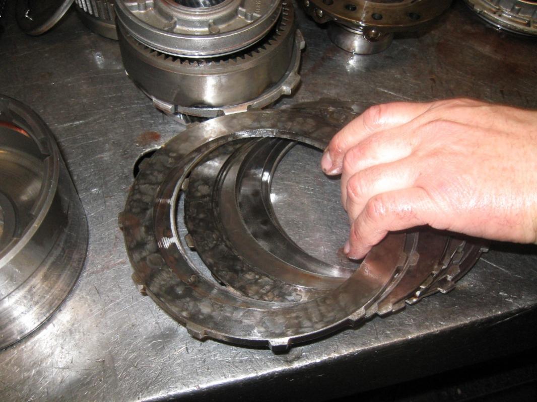

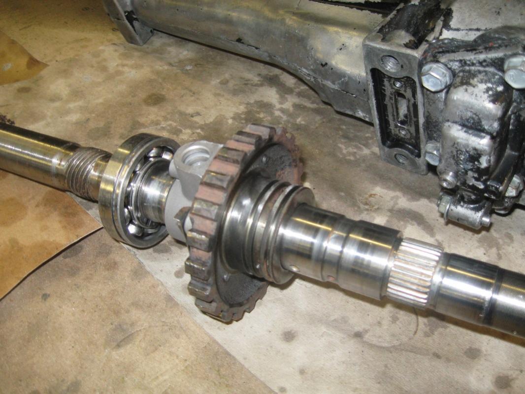

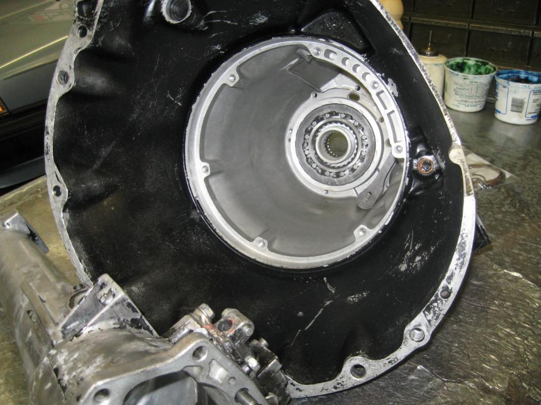

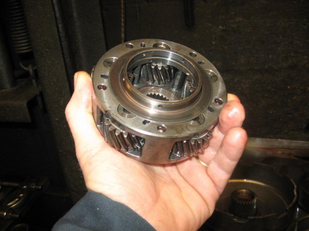

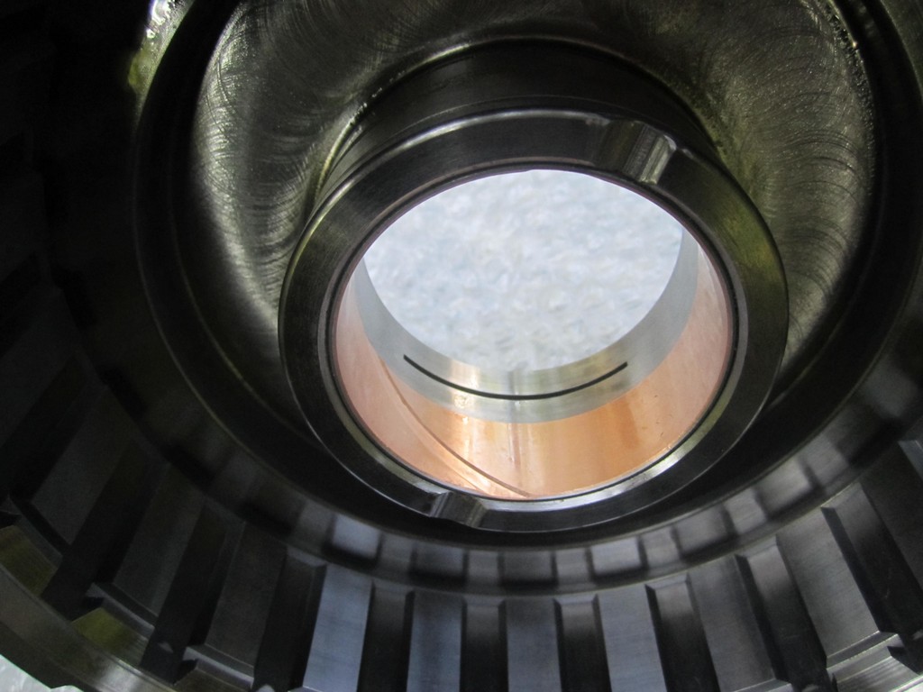

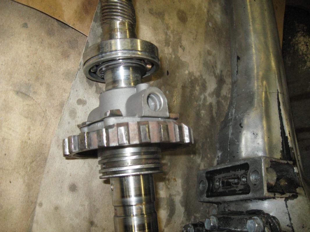

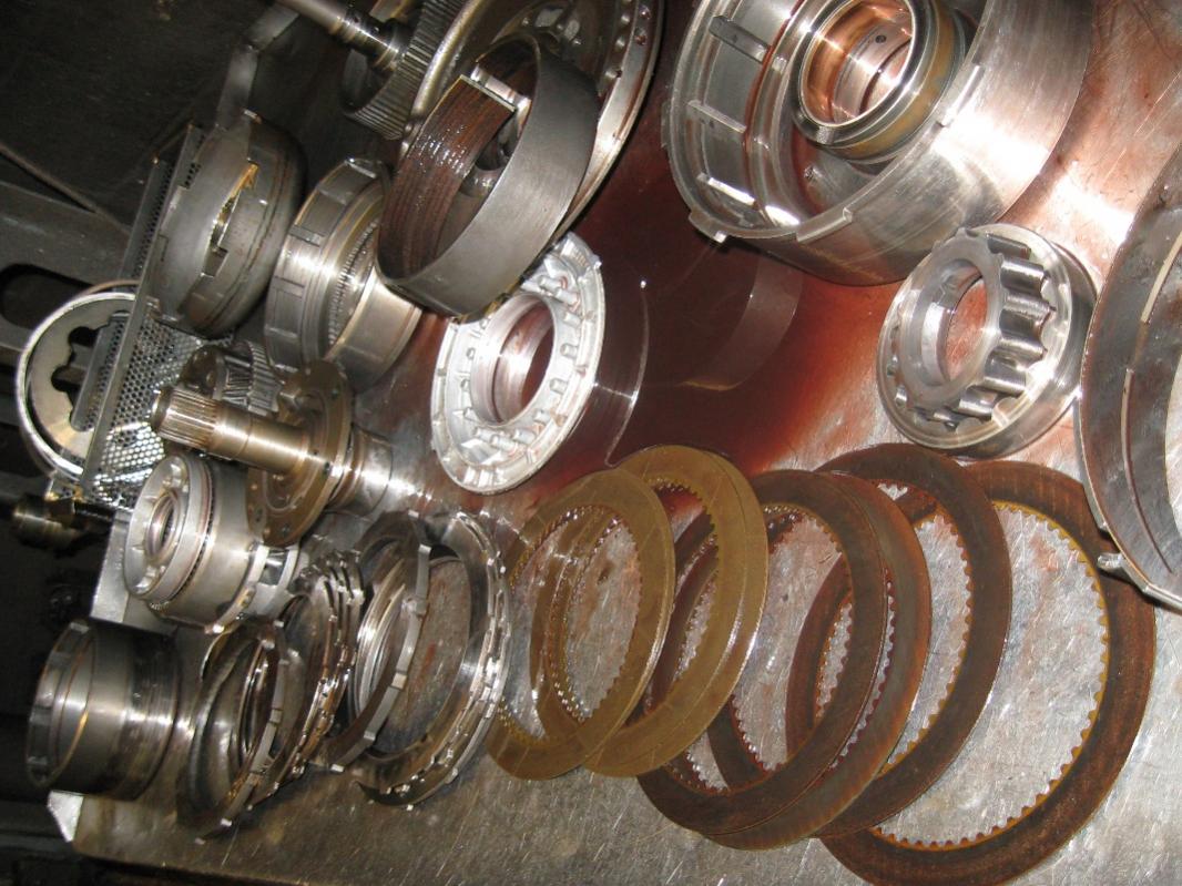

The pushbutton trans can be updated with with the 66 & up front shaft & pump.Depending on how much power you ultimatley want to use would determine how the unit should be built:blob1:

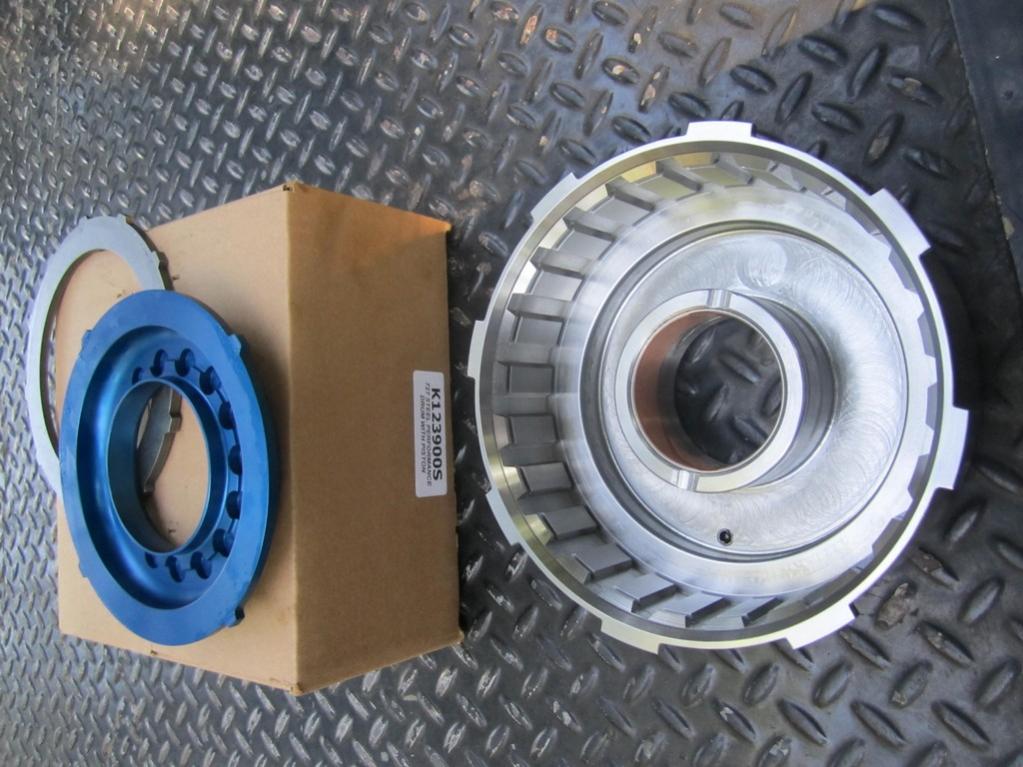

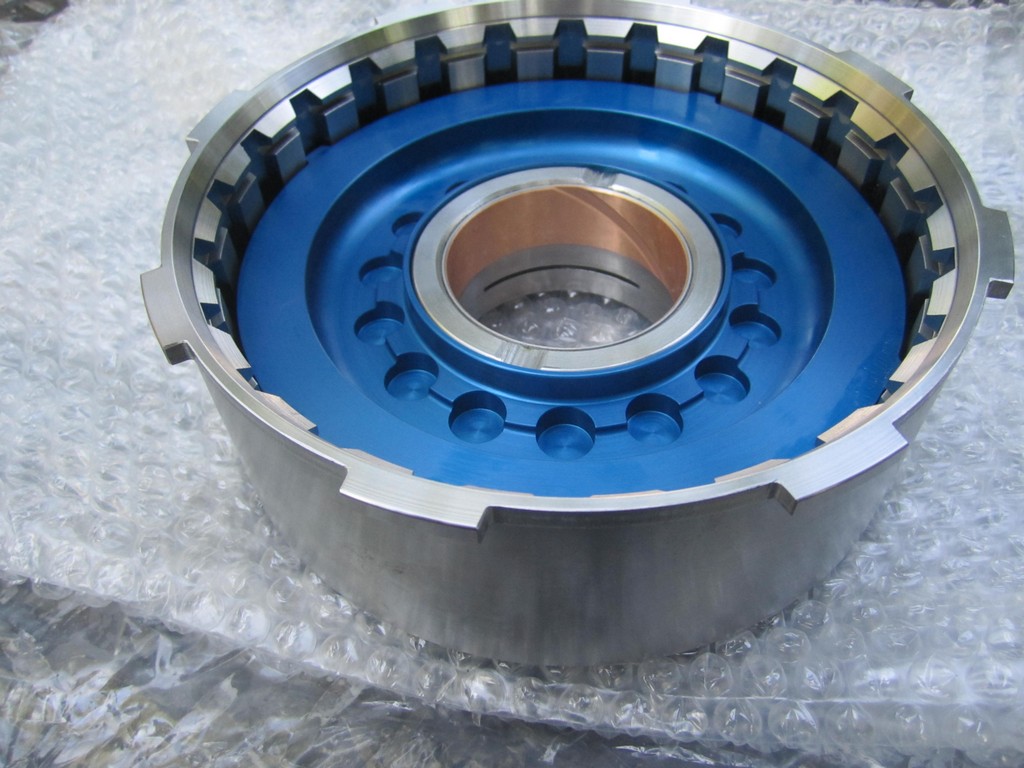

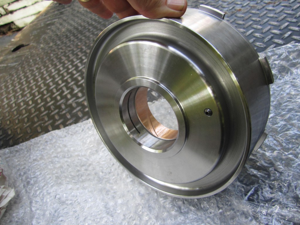

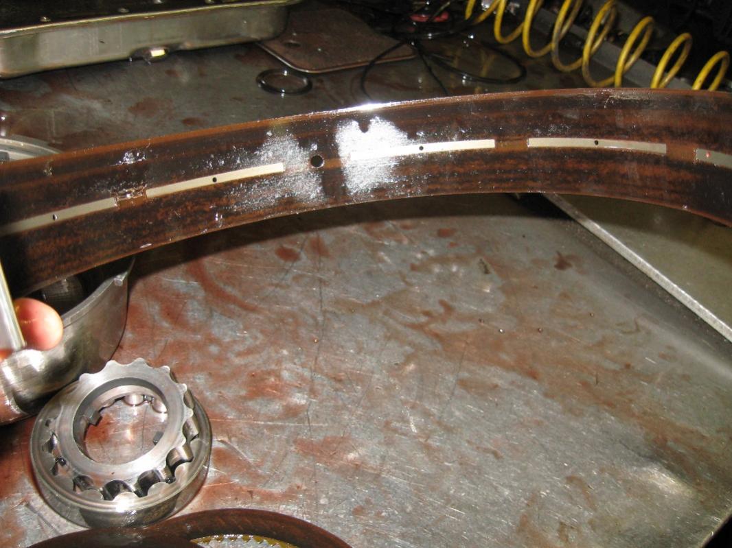

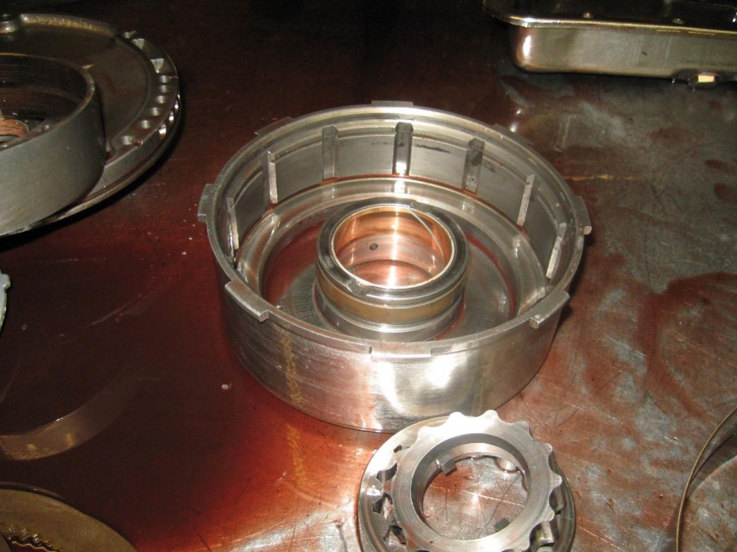

The 5 pinion steel and billet steel drum are logical up grades for higher hp and torque.
