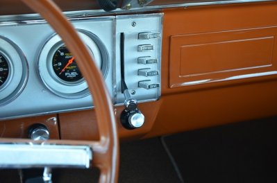

For the guys that run a pushbutton shifter, There's a way to make the buttons easier to push in.
The reason I'm asking is when I launch and get thrown back into my bench seat, it's a little tough depressing the buttons hard enough where i'm missing my shift by about 200-300 rpm's.
I have in the past lowered my shift point but I remeber doing something to my nuetral safety switch to make the pushbutton feel easier on the thumb.

if you google articles about PB TF set ups for racing there were some beefing up tricks done such as with the servo springs. The button linkage (behind dash) has springs behind each button and suppose there could be lighter replacement springs installed. However, there is other linkage engaging allowing the button to "click" into duty via a pivoting-locking cross member. Before messing with the springs ensure that the linkage is operating free as possible as over time (as I've found out) dust and grime accumulates and even some superficial rusting that can cause some sticking. A thorough cleaning and polishing can be done and use a light lubricant such as track grease or Teflon lubricant as oil or grease becomes a dust-grime magnet over time. Interesting how Landy remounted the buttons to the roll bar assuming the buttons were set closer to him aside from the "fans seeing his shifts.."

This is good information. Thankyou . I'm going to check out the mechanism behind the dash and lube it up. I wonderif graphite would work as well?

Graphite has the lubricating "properties" that bind and repels dust/grime as you likely already know sounds like the ticket for the linkage; even the stuff I used while a clean lubricant still can attract dust. Sounds like a better item to use...on the topic with all the work you have done on your tranny ($4500) reckon the shifter cable is all sound or replaced no possible issues with binding, etc.? A common problem with them is the sheathing deteriorates or has separated causing leakage. I did a cheap fix on mine a few years ago that's still holding up but someday I'll divvy out the cash for a new one if it leaks again since I have a long list of stuff to do on my '63.
Lube the buttons and the springs behind the instrument cluster, then put a lower tension spring on the rooster comb at valve body. may be able to grind a coil or two off the spring to lessen the tension.
