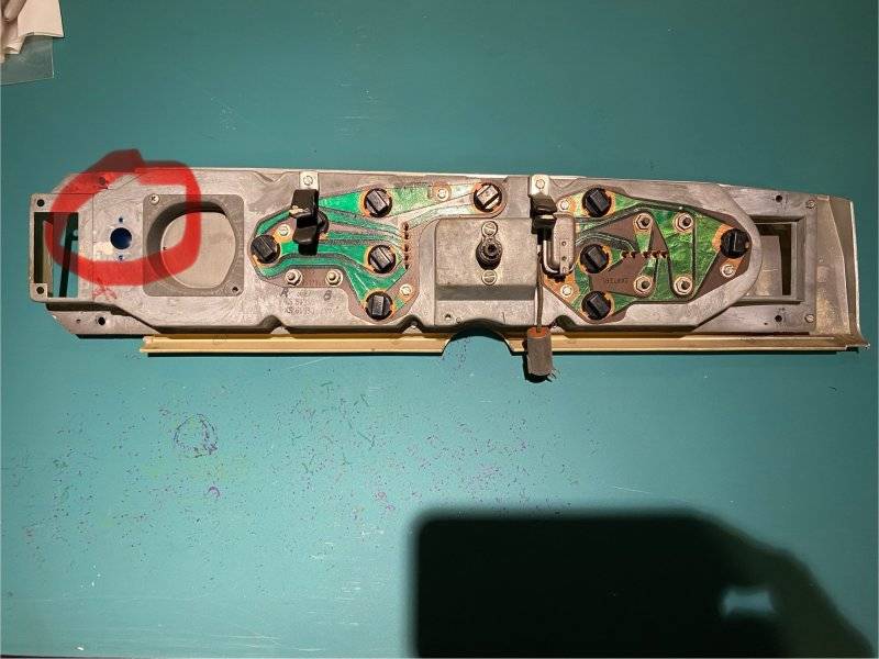

No. The lightbulbs are all either mounted to the circuit board or mounted into the dash frame. Picture of the rear of my 65 dash frame below. The heater buttons are backlit by a bulb that is mounted into the dash at the red circle. This bulb is mounted in a socket on a the end of a wire that comes from the harness. Not sure the earlier 60’s dashes are the same, but I would suspect they are.

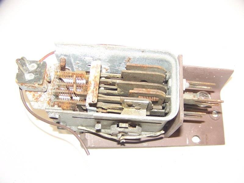

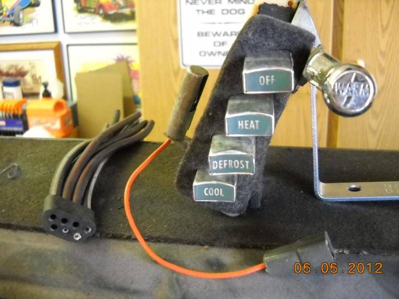

The thing is, the controls aren't in the cluster itself.. this is a pic of a 63 but same idea, the shifter and heat controls aren't part of the circuit board.. i'm sure there is a socket on a wire.. will crawl under the dash and look tongiht, sure glad i thought to do this before putting the seats in :)
i don't think removing the cluster is necessary. i think you only need to remove the plastic gauge bezel to access the bulbs. the heater bulb is inside a steel light deflector and the shifter bulb is located at the center of the plastic push buttons where they join to the shifter. most dash lights on a mopar are orange wires

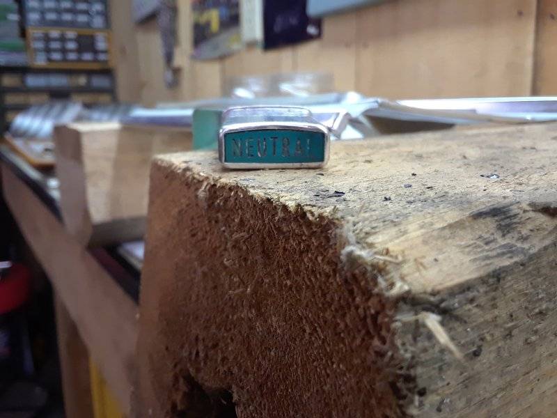

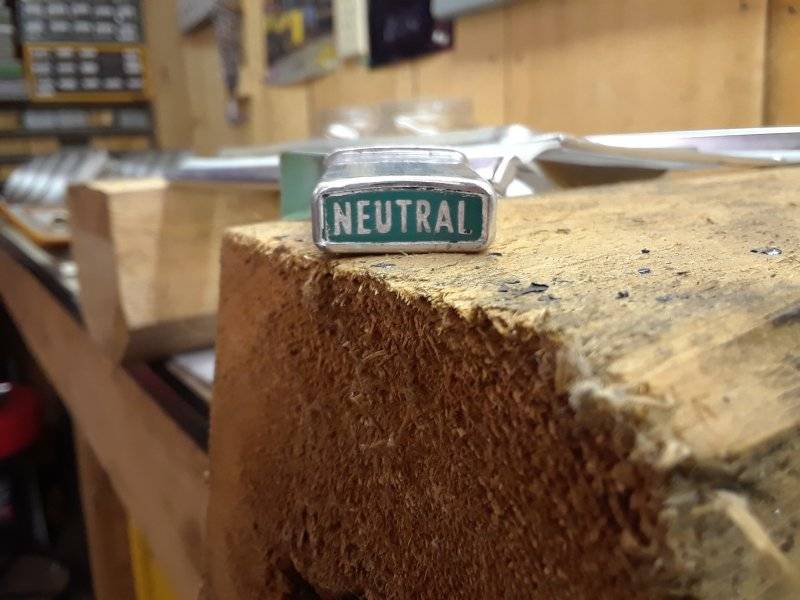

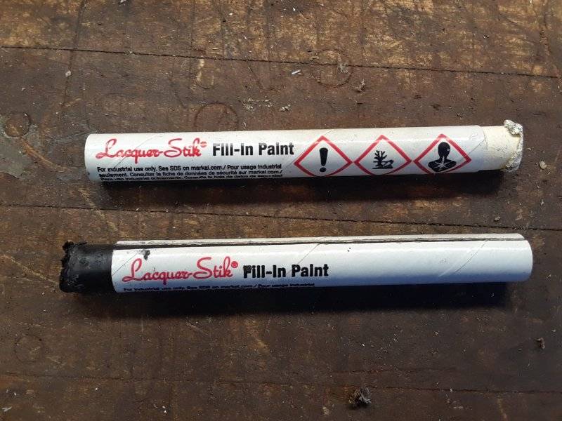

Also... anyone know a easy way to replace the worn out words on the shift buttons? thanks..
I used the product in the attached photo. I believe they are available in white, black and red.
Thanks charger, got it all apart and was no biggy.. glad i did, it all needs a good cleaning.. those plastic push buttons/stalks look fragile.. gonna order all new bulbs, trying to decide on led or normal.. i kinda like how soft the normal lights are
OHH.. that just rubs in the clean off the outer... awesome :) will grab some
Yep, just cover the complete button with the stick (push hard to get into the letters) and wipe off the excess.

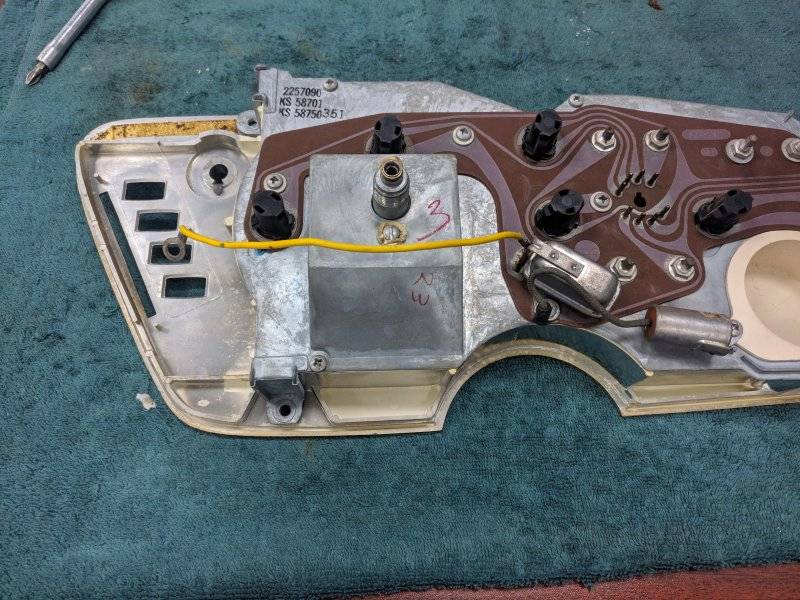

K.. brought my cluster to work to clean it up and put in the new bulbs and stuff (i have a lot of dead time at work) and when i pulled the cluster this yellow wire wasn't hooked to anything, grou although the whole dash seemed to work.. i looked on a schematic/layout but can't find it.. where is this supposed to go? Ground that was behind one of the cluster mounting screws that i didn't notice?
P.S. looking at the trace it looks like a ground, just wanna make sure, hate to let magic smoke escape..

P.S.haven't hooked up that yellow ground.. need to find a spot for it, doesn't seem like it's needed though..
