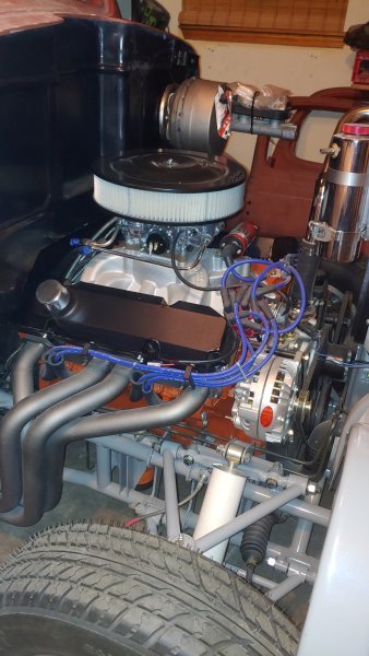

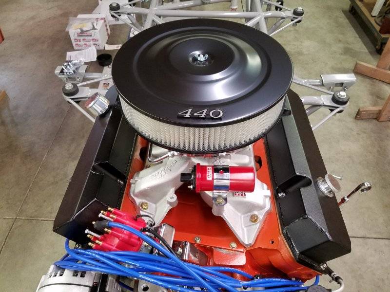

The 505 makes good power, never been dynoed but pulls like a freight train. I only have oil out the breather after some spirited full throttle fun. Crank case pressure can get pretty high, the tell is my valley pan has been pushed up to the bottom of the intake and finally cracked, making an oily mess. Replacing the valley pan right now, but need to do something to relieve that pressure.
It has a PCV valve in the left valve cover, and a breather in the right valve cover, the breather leaves oily residue on the valve cover.
What are some options to fix this?

Ballooning the valley pan is not a good sign. I wish you luck bud. As stated, a little confusion between posts on breather status. .028 ring gap not really excessive on a 4.32 bore. Any detonation issues? Again, leak down would be advisable.
No pcv on this one, with only
one breather in passenger
side valve cover. You'll
notice the valve covers are
taller than stock, and the
breather side has baffles.
There is zero oil "mist" on
top of the valve cover. There
is almost no vacuum at hard
acceleration. (the pcv valve
ain't doing a darned thing).
We (engineers who spec'd
an built the engine) did an
oil splash test using a faux
valve cover with spacers
to measure rocker oil splash
major accumulations at
different heights. Almost no
splash was recorded at
about 3-1/2" valve cover
height. Contrary to what was
posted earlier.....breathers
in the valve covers do not
draw air in, they vent out at
much lower pressures than
intake air. If you do have
excessive venting thru the
breather in the valve cover,
that air is being pulled past
the piston rings. If there's
enough pressure in the
crankcase to force oil leaks
and deformed intake valley
pans...it's definitely a piston
ring problem. Broken or
misgapped. I would follow
the advise of others here
and protect your investment
with a simple leak down
test.
