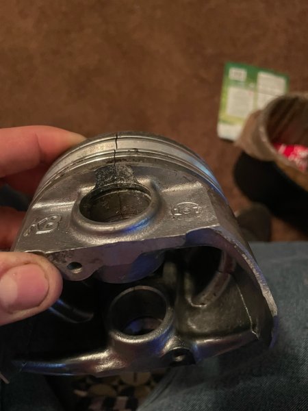

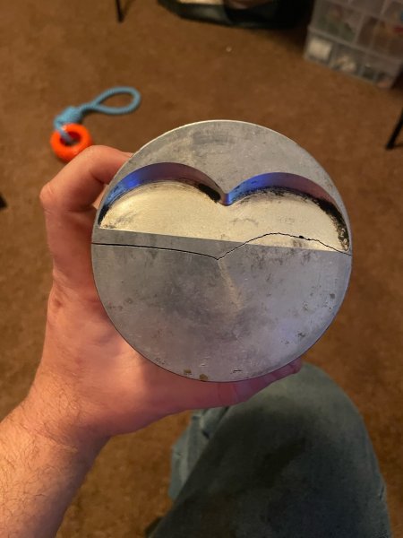

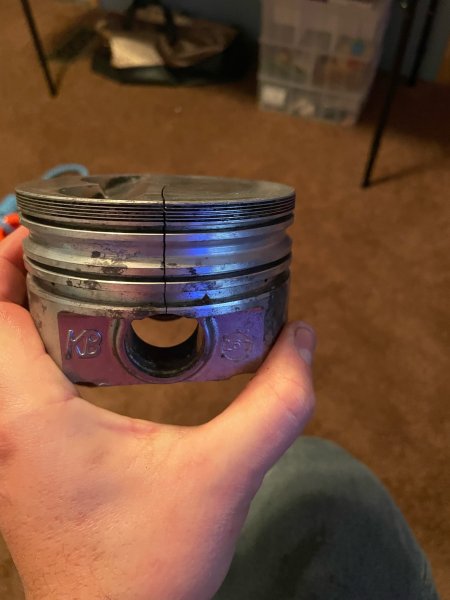

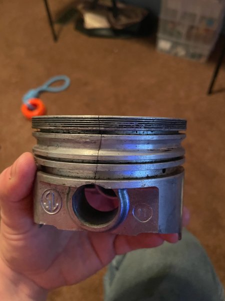

Here is the KB167 piston that cracked. figured id better share these so you all get the full picture. Again the machine shop was supposed to checked the cylinder hole to make sure it wasn't egged out and still true. I really wonder if they messed up the installation of the wrist pin. A floating wrist pin would be quicker to make noise then a press in wouldn't it?
The floating pin is only easy to mess up because you fail to put the locking rings in or correctly. If so, the pin would slap the cylinder wall... but would that create a consistent knocking? and without spark? Dunno.
As for press fit... it's super easy to jack that up because it's easy to mess up the heating process and easy to mess up the step of inserting the pin while at the right temp. If you do it a lot, it goes super quick. But I've seen great shops hand that work to the NFG who get's it wrong.. not centered, bites in the piston, etc. The issue with pressing pins is it looks easy enough, but if you don't time it right... it's a sh1tshow and things start to go sideways quick.
BTW... that crack is pretty good... kind of surprised she didn't fly apart...

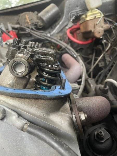

Ok everyone, first off PADAM thank you for the stethescope link. I used it today! I am getting this noise from drivers side of motor and it seems to be coming from cylinder 7. It literally almost sounds like a lifter not staying seated on the cam. I really doubt thats the case cuz hell you'd figure id flattened the lobe by now?... I took Valve cover off of that side and bumped ignition around and checked all the rocker arms. They all seem good, although there is this side to side movement on some of this. Would that cause this noise ive been chasing? If so it did it when i had stamped steel rockers also. When i had the previous rockers it made me wonder if they got out of order from the machine shop. I had them oriented correctly between intake and exhaust too. Here is a video of me wiggling some rockers for you so you can listen. And some photos of how close the rocker arms are to the springs. I'll have to try again on the photo. Need light behind the springs so see how close they are
Get some gloves. Run engine at idle, with fingers resting on suspect rocker arm. Sound will change if there is a problem.

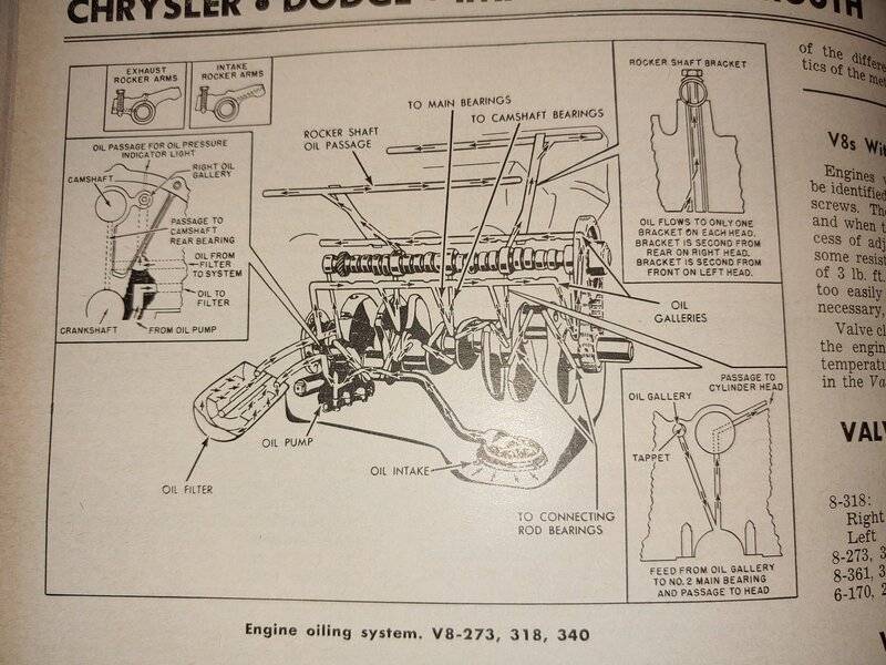

So quick Add. I did a search and found the schematic for the path of oil travel. If I am seeing this right it seems the oils furthest point of travel would be back to cylinder number 7 on the drivers side of motor. That's where my noise is that really sounds like a lifter.

I will do that. I did watch the rockers with the valve cover off. Tho i do believe with my lack of oil pressure is causing a problem on the drivers side. While watching it run i didn't see the rocker going side to side. I will try the glove method tho! thank you geoff
Still not trying the simple method to isolate the noise.....
Held every rocker arm and revved it. I don't think that side to side play is making any noise. Every small block online that i've seen makes 35 to 40 lbs of oil psi. I adjusted my lifters some more today and i swear the noise moved up in the rpm range. I really hope that after dropping oil pan and checking everything underneath that if all checks out well that i oil pump gasket i have will make a difference.. The motor did get a lot quieter at idle. Less valvetrain noise. If i wind up having to get a new cam and lifters... well, i can't say that my feelings will be hurt at all. Id love to try out a difference cam.
