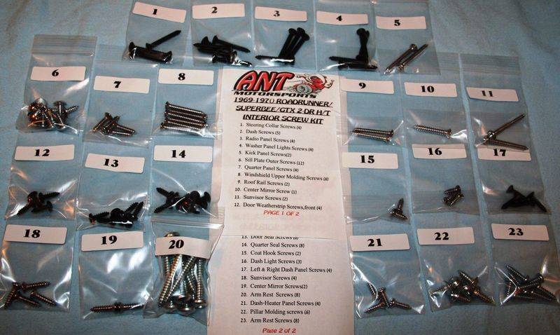

My best way of figuring out what bolt went where was to go online and look at specific hardware sets. Lets say interior screw set. each screw set is labled with a map of where they go in the list.
Or a list like this..
http://www.521restorations.com/index.pl?page=bbody&sub1=Fasteners
Thanks for the tips. Good idea on searching the listings like that. I am sure I will need to purchase fastener sets. Its just seeming a bit overwhelming at the moment ha.
