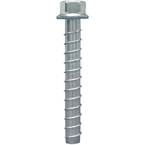

as a contractor i would use Simpson Titen H.D bolt...just drill your concrete floor then drive this bad boy in... just make sure you "Don't" have a post tension concrete floor...the floor should say it if it was...also I'd use a 1/2 inch impact electric driver and it works very hard driving it in, i would use 6" Bolt's
http://www.strongtie.com/products/anchorsystems/mechanical/titen-hd/
