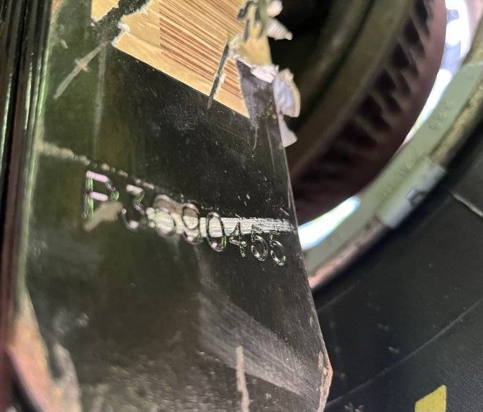

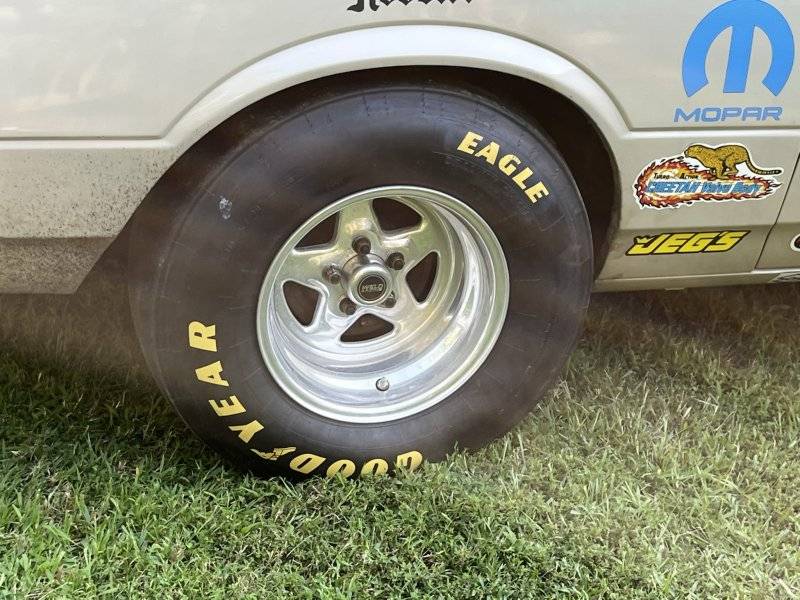

On the J body Imperial Stock Eliminator car I just bought the car leans real heavy to the passenger side. I finally got a chance to look it over. The guy had just put Mopar Super Stock springs on it. P3690455 driver side & P3690454 passenger side. Both are 3800 pound B body springs. The right side spring has the rear shackle well to far back. 40 degrees & the left side is at 32 degrees & looks about right. I’m not sure what’s wrong here. Unless that right side B body spring just doesn’t work in a J body car. So I’m thinking about buying another left side spring to install on the right side. However there’s another issue. The rear axel is not centered. It’s 5/8 further back on the right side. Don’t see how that can be since both springs have the same 20 inch front segments. Puzzeled is what I am.

Yes he put brand new size matching slicks on the rear. Goodyears & he also put brand new size matching Goodyear front runners on it. Air psi is verified & correct to how he told me he ran the car

Look at the passenger side "454" spring and you will notice that the second spring leaf stops well short of the rear spring shackle when compared to the driver side " 455" spring, where the second leaf extends almost to the shackle under the main leaf. Over time, this lack of support of the passenger side main leaf causes it bend down and sag. I have had this happen on my B-bodies with these springs, and remedied it by using the "455" spring on both sides.
As to the seeming difference in tire to fender clearance; have the 1/4 panels ever been replaced, possibly improperly? With front wheels pointed straight ahead, measure your wheelbase from the centre of your front hub to the centre of your rear axle on both sides of your car. Any difference would have to be corrected to make your car track straight.
