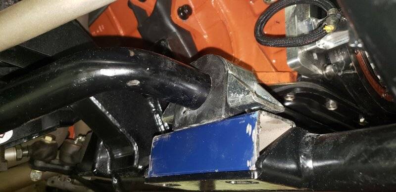

Also, the QA-1 Subframe mounts the Sway bar way to low.. I made 1 inch blocks to mount the sway bar above the subframe. Running the Subframe and Lower Arms with Hotchkis TVS.
I've got to admit that low sway bar mount concerns me a little. I'm intending to use a 1" drop spindle. I might be able to find someone who can fabricate brackets to move the sway bar mounts. Maybe.

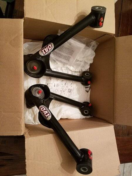

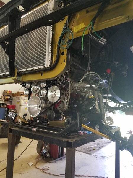

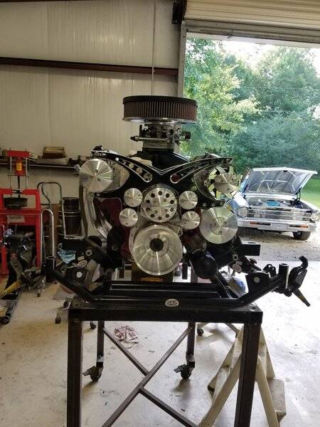

View attachment 1274100 View attachment 1274101

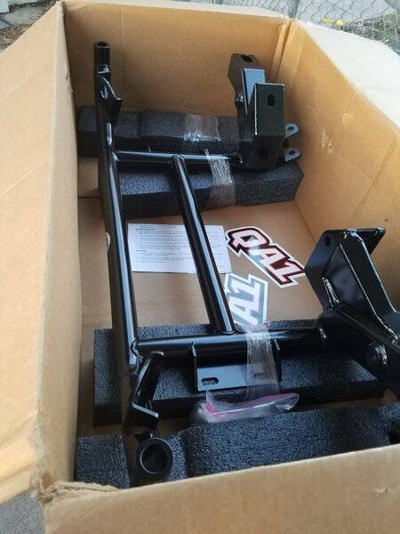

That doesn't look like either of the k-frames QA1's website shows when I have 72 Charger selected. Do you have a picture of the frame by itself?
Are you running a front sway bar?

Not yet, and am not sure about finding one that will work without coilovers.
Yes,sir, the torsion bar and lower control.arms attach to the blocky end. Nothing on the front except the strut rod mounts.
Do you have any more pics of the way you mounted this, especially to the LCA. I’ve got a set of LCA,s I was going to weld sway arms tabs to make them work on my 70

Will you ask them why in the world would they mount the sway bar under the k-frame and not through it like a member here did and they mounted it through the k-frame on their coil over k-frame so what gives?

My 70RT is a factory sway arm car. I was looking into maybe adding a tubular K-frame replacement, not coil over. I’ve already got the upper and lower Qa1 control arms. I do realize that Qa1 tries to get ya with if you run our LCA,s you need our k-frame but that’s an easy fix for my 70 by just welding some LCA tabs on their arms. I absolutely hate how Qa1 made the sway bar to mount below the K-frame. It’s is way too low.

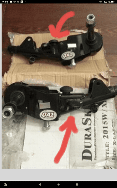

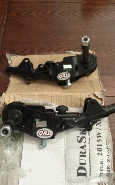

Here some more pictures.. Now I did not buy or try a QA-1 sway bar, since they don't make a rear sway bar, or didn't at the time.. but the mounting is poor design, but fixable..
