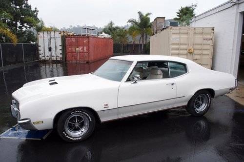

it's a 72, .. don't think Buick used the slot manifold, but I'll keep it in mind thanks
> replaced throttle plate & shaft <.. took it in to old school master that a friend of a friend knew and he found time to do it .. he is 88 years old ..I had the pleasure of sitting with him while he did the carb, the man has some stories .... wish I had brought a video camera to catch his stories as his old hands worked on it ...great couple hours for a youngster (68) like me .. thanks for input
Yeah shaft and one of the plates was worn .. carb has been around for a while, but it original to the car I think
I thought you were running a mid to late Eighties truck 360. They had Q-Jets (Barf) because it was about that time that Carter went into the dumpster.
Nah, its a Rochester on a 350 Buick GS.. actually I don't think its a bad carb.. pretty simple design, a little economy on primaries, and big secondaries.. it's just old ...like me
