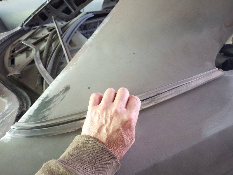

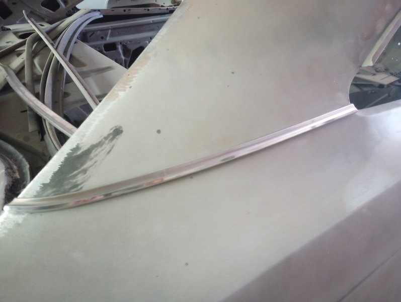

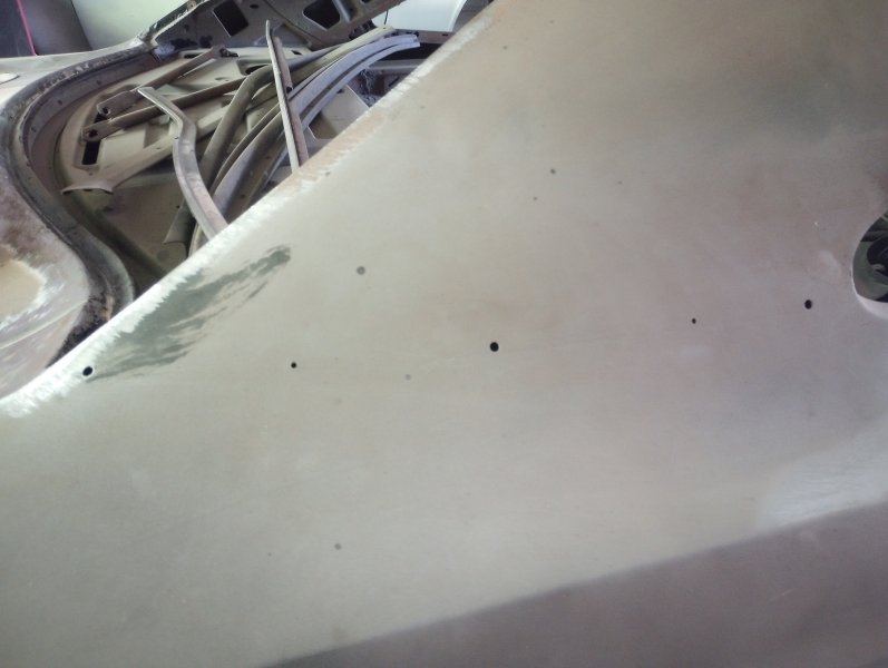

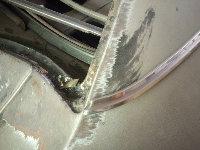

I do..... don't use a Dodge as an example, they are different........I'll get pics in a bit
if you have the trim pieces it's pretty obvious

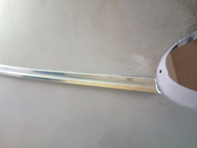

this is my 68 GTX........ these holes and trim are original........ the 2 little holes were phillips head screws through the vinyl holding it down
I believe the bottom piece of trim came off a 68 Coronet, it is longer and sits lower than the GTX
