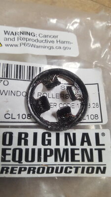

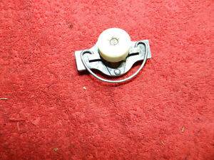

I guess I will have to wait for the kit to get here. The pictures made me ask. The ones I see look to be the double roller on a stud with a clip to retain the second roller. At least that is what the picture shows. This picture shows the ones I question the most.

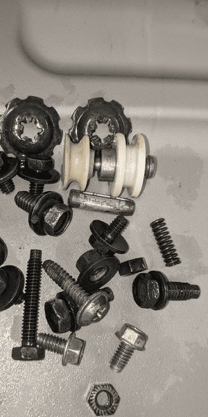

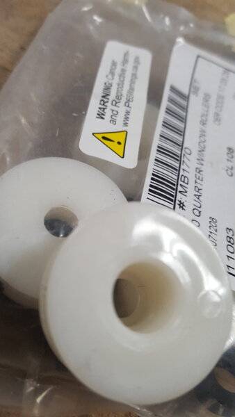

The bushing pair in the second pic when you get them will be a little fatter than the originals. I filed about .020 off each flat side so the lockrings snapped in right and everything was free. All the rollers were just a little different.
Yes that internal lockrings makes it fun to get 50 year old nylon off, a heat gun and a small puller works, or cut and break them. If your originals are good and not cracked reuse them, the new ones are a little different, like everything.

The clips came off easy with a 90 degree pick. All my rollers are ok. I just do not know how worn they are. Just figured this being a nut and bolt restoration I would update them. Just like you saw there are differences. Most of these restoration parts are mediocre at best. I call them CCJ. CCJ= Cheap Chinese Junk.
