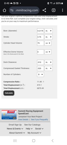

Well, I don't understand how you get quench without getting to much compression, I've got a 413 I'm gonna tear down and rebuild just to learn and have been playing with this compression calculator, closed chamber heads, 413 bored 30 over and a 20 thou steel head gasket with 75 cc chamber heads and flat tops, maybe somebody can fill me in on this

Yes I read post 3, i understand you need a dome piston with open chamber heads, but with a closed chamber head can't you just use a flat top piston and maybe deck the block or mill the head, how do you get a good quench though without getting to much compression, that may not be possible I have read you can run more compression with aluminum heads though

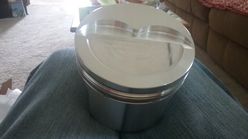

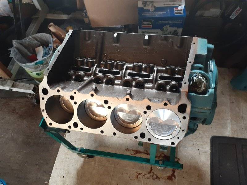

some call them D shaped
diamond pistons made me set for my 413 years ago and they had flat tops with 4 valve notches which took -6 or -8 cc off can't remember. the D shaped for the 440 had a -14 cc.

I don't think so. It will be @ >10:1 CR (10 cc) with an iron head. Details matter.
my 413 .030 over with 79cc heads 8cc valve notches .038 head gasket with 4.45 bore and .005 in the hole pistons was 9.75. I would never use a steel .020 head gasket which I think you were thinking of.
my 413 .030 over with 79cc heads 8cc valve notches .038 head gasket and .005 in the hole was 9.75. I would never use a steel .020 head gasket which I think you were thinking of.
No. I used 0.040 piston to head, and 78 cc.
With your numbers I still get 10:1. Again, details matter.
