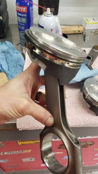

I only have a 400 block that displaces 500 Cubic inches, AND I don't have many miles on it since I tore it apart to address low(er) oil pressure and some potential piston slap. Note that I bought the engine complete with about 5000 miles on it. Great, top notch parts, but I tore it apart due to the issues mentioned and I am now almost done the rebuild.

With a long stroke, the rods get very long so the pistons must get very short. Your pistons will have the pins encroach into the oil rings like this:
Overall, here are my pistons and rods:
You can see how long the rods are and how short the piston is. With a 4.5" stroke, you will get a lot of side load, and this will be with that short little piston partially out of the bottom of the bore. Bottom line is there is nothing you can do about that short of reducing the stroke.
Interestingly, I am assuming that my Eagle crank had lost about .001" size on the main journals in 5000 miles. I say assuming because my main journals are now almost .001" under minimum spec. Is this due to side loading? I don't know. I believe this was the cause of my low(er) oil pressure.
Best you can do for side loading is pay particular attention to engine specs when building it. Make sure your clearances are spot on. Don't guess, measure every one and I'd say to go for about .003" main clearance. Make sure oil gets to the mains and flows. High volume and high pressure are not necessarily always better. You want the crank to ride on a pressure wave of oil around it. Too little or too much flow is a bad thing. With pressure, more is not necessarily better. Pressure is a good indicator that you are pushing oil through the mains, but too much pressure isn't good either. What you want is excellent oil FLOW to and through the mains. Talk to your engine builder about optimizing that.

The bore length in a 572 is long enough to allow for a 6.76 or 6.80 rod as opposed to the 7.10 rod frequently used. This combo may need some crank work depending on the counterweight diameter, but I prefer the longer piston skirt that it provides for a more stable piston and better ring seal. My old 572 ran for many years in this configuration.
Put the longest connecting rod in that fits the combo. The longer the rod the less rod angle so less side load. The pistons in new Hemi's and Ls, Lt engines are 1.200 or less compression height and they go 200,000.
