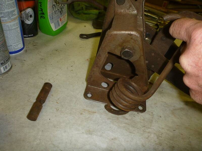

For a 68 Charger, I am converting from automatic to manual transmission. while assembling the pedal assembly I have come across a dilemma. What holds the overcenter spring to the pedal housing ? Having researched this, having very little info, hopefully someone can help with this. Thanks
The pin has two grooves, the grooves locate on the pedal support frame & the pedal spring keeps the groove firmly locked to the frame
BTW if your using a diaphragm clutch you don't use the spring..
One thing to consider. If you are going to use a diaphram clutch, you shouldn't use that spring.
