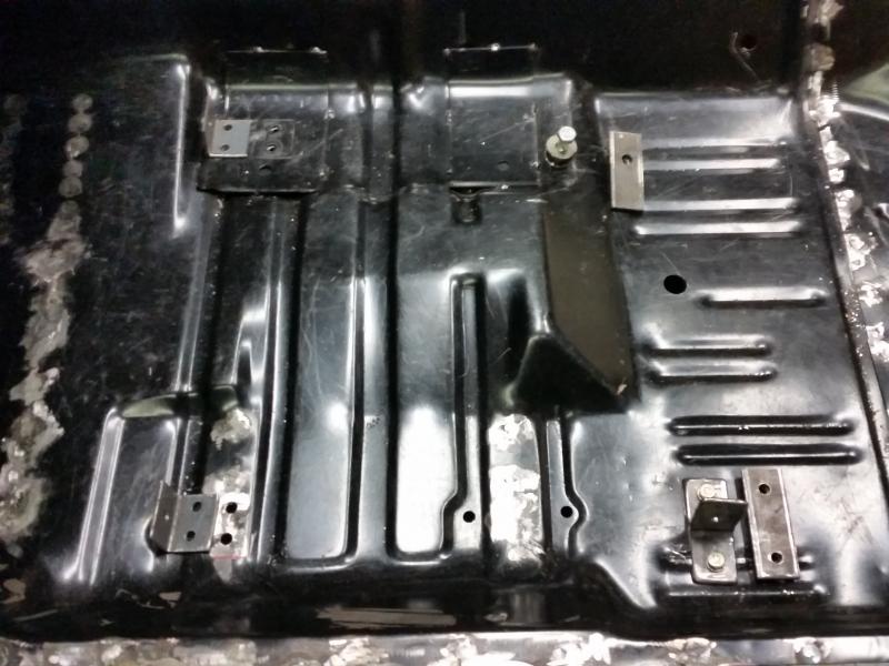

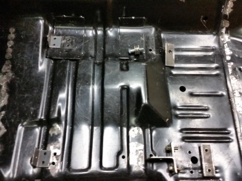

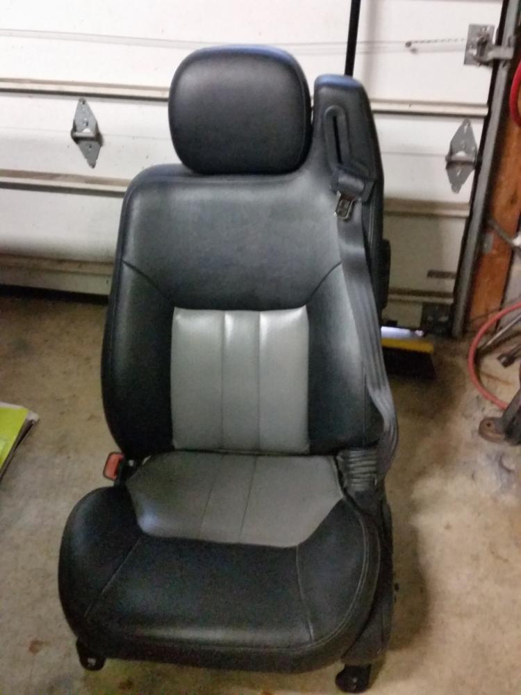

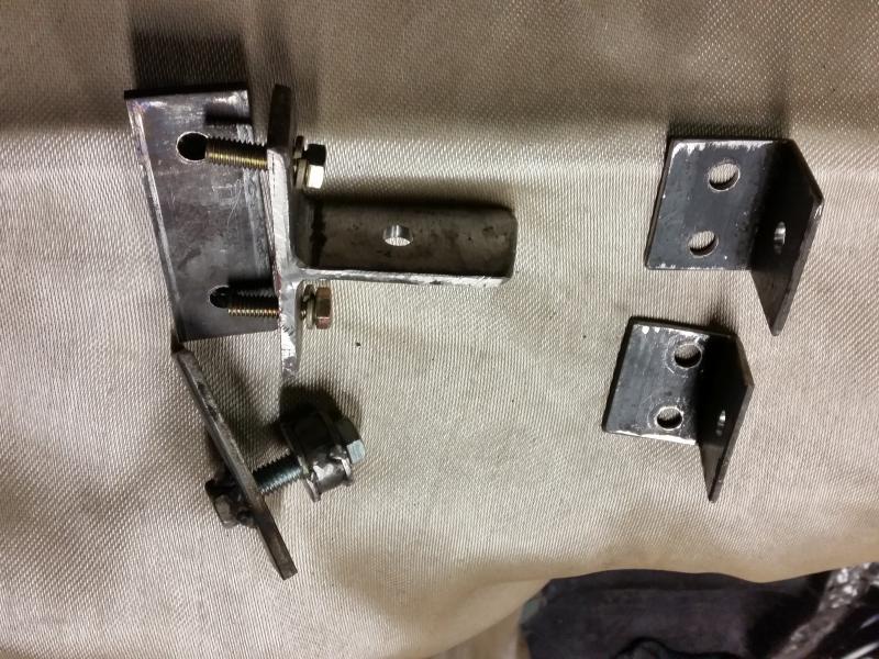

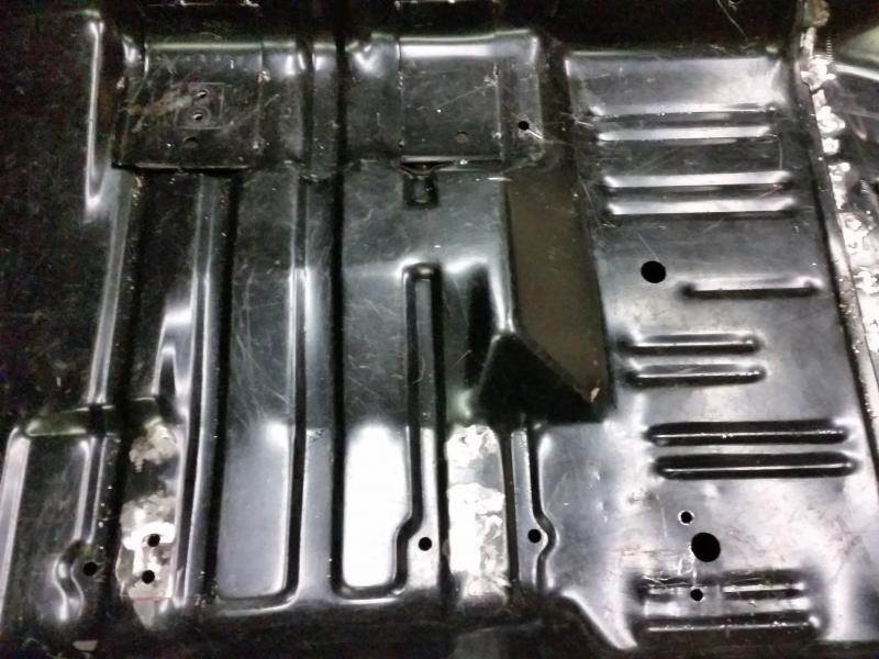

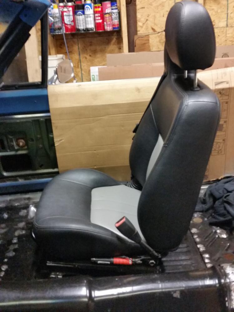

I have been working on a pair of 2003 Sebring Convertible seats to install in my '68 Satellite convertible. The seats have built in 3 point belts, and the Driver's side has 6 way power adjustment. I was able to make simple brackets to mount them using the factory bracing for the front mount and making some plates to mount under the floorpan for the rear mounts. This required a few extra holes, I plan on using plugs to seal up the factory holes..... It took a few trips to the Pic-A- Part yard to get a decent set, paid $85 for the pair....

Satellite, those look nice.
