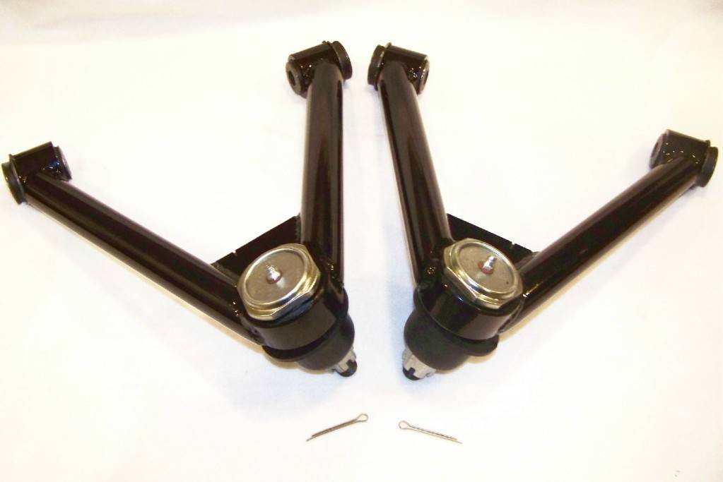

I have started making tubular upper control arms to fit B&E body mopars and have a question about all years and models that they will fit. They are made on jigs taken from a 73 Cuda and have been test fitted on the frame rails. They feature and additional 5 degrees of caster and a little extra positive camber for lowered cars, but I will work great for factory ride height too.
I know they will fit 70-74 E Bodies and 66-70 B bodies, but what else will they fit? or what other models will they fit?

pretty sure 70-74 e bodies will only fit 68-70 b bodies which include any of the above metioned in that year
70-74 cuda
70-74 challenger
68-70 charger
68-70 RR
68-70 superbee, coronet
68-70 gtx, satellite, belvedere,
k members upper and lower control arms are all similiar for these models
what u charging for these babies?
They are the same price of my A body uppers. $200+shipping They come with Raybestos bushings and ball joints too.

Very good to know. I had all of this written down somewhere, but have misplaced it. Thanks
B's up through 72. 73 they changed.
I have a stack of arms 62-72. I know the 66-72B and the 70-4E are the same. I can compair them to the 62-5B but I thinking that they are the same size too.

A Mopar shop I know of says that the 66-72 arms (like Hotchkis) will work on a 62-65.
