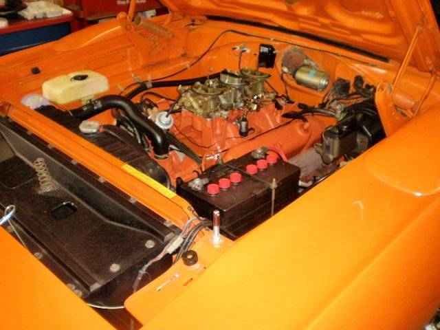

Don’t tell anyone but those are GM tri-power Holley carbs with mechanical linkage, not vacuum. And they work freaking amazing.
Ran/run sixpack both big and small block since the early 70's,"never" had any issues of fuel bowling or anything else for that matter,if set up correctly,they work.These haven't been touched in 15 + yrs,runs as it did then.
