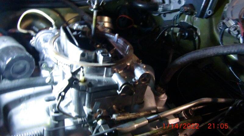

Just to close this thread out, I adjusted the choke open to this position and engine fired right up on this cold 50 degree morning. The plate cannot get closed any more than this position no matter how cold it gets. Thanks to all for the help.
Just to close this thread out, I adjusted the choke open to this position and engine fired right up on this cold 50 degree morning. The plate cannot get closed any more than this position no matter how cold it gets. Thanks to all for the help.View attachment 1224343
Does it have a choke pull off? It's usually a small dash pot hooked to a vacuum line and choke blade. You you first set the choke by depressing the pedal, it should close all the way and upon fire up, the dash pot will pull the choke open some. There's usually a linkage rod with a 'U' bend in it that can be adjusted for the amount of pull off you want.
