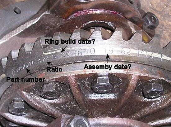

Where is the date code on a 489 differential case and is it a regular calendar date or a 10,000 day calendar date or something else?

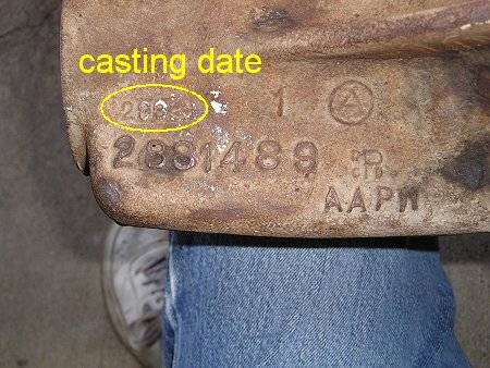

Mine showed a casting date in week/year (29/8) format. There are a couple of date codes on the ring gear
