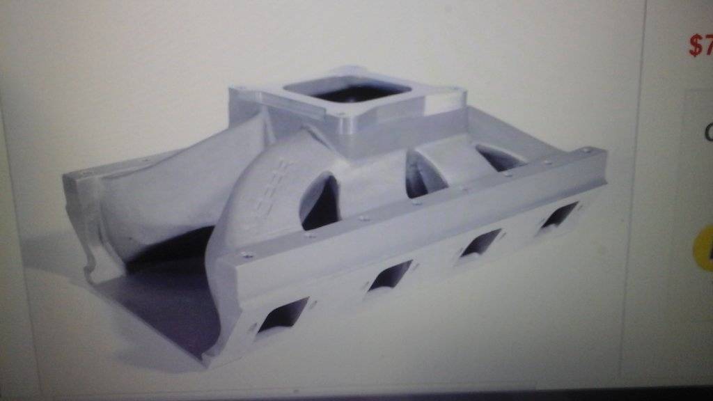

Does anyone know if this intake manifold that Ray Barton sells fits under the hood of a 68 Charger with the oval, single four bbl air cleaner, the carb would be an 850 Holley??

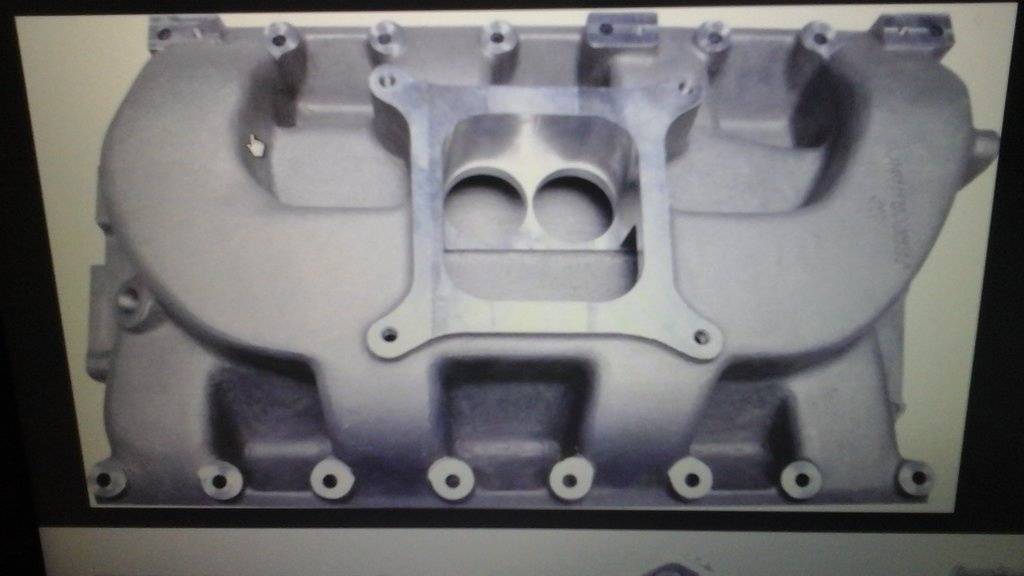

The intake manifold from Classic Industries mn2761 (that says arriving soon) has said that for 10 months, I ordered one but they can't seem to come through with it. The Engine is in the shop being built so I have nothing to measure from or with based on the info Ray's site gives. Need first hand knowledge. The lower pic is of the Classic Ind. intake.
Has anyone had one of these Ray Barton intakes on a Hemi in any B body with a factory hood??

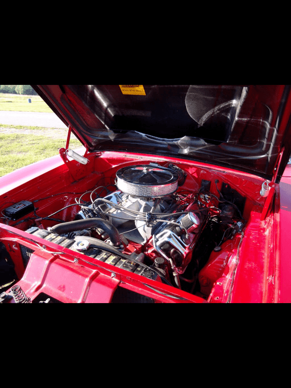

Here's a picture of my set up. That's with a drop base air cleaner. Sticks out about 2 or 3 inches on a 67 RT
I know a guy with a 70 Charger and No, it did not fit. He had a scoop on an aftermarket hood. I'll see if I still have pics and post if I do.
