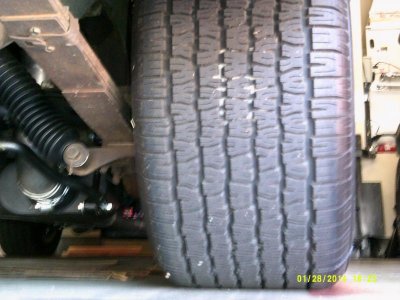

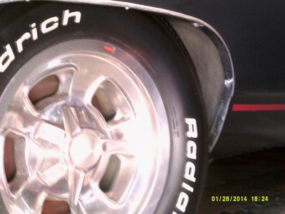

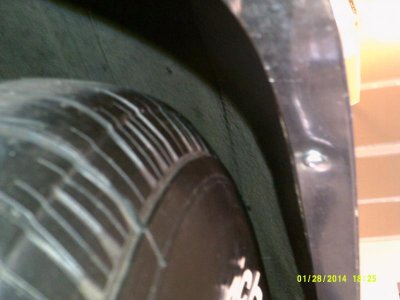

  • 68 RR 295-50-15 Radial TA on Edelbrock 15 x 9.5in w-5in BS outer clearances.jpg

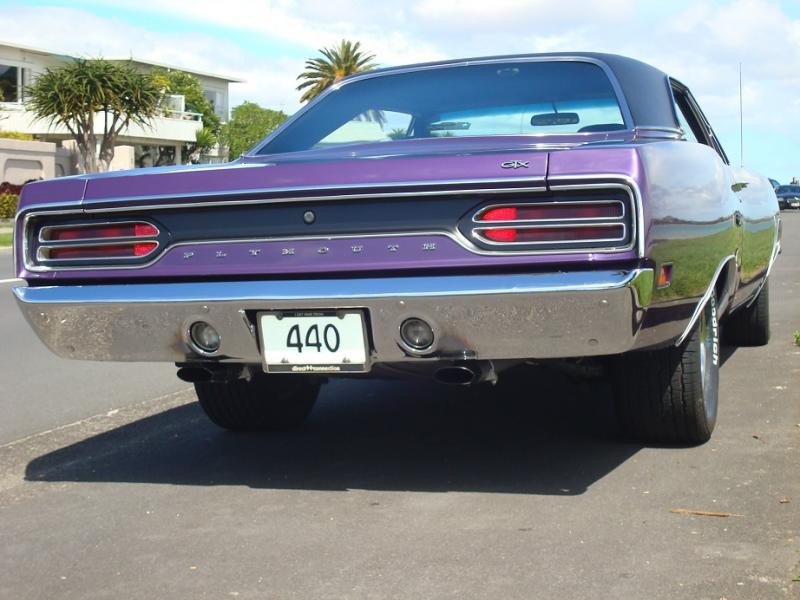

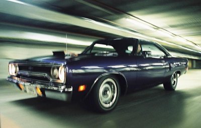

1970 Plymouth GTX - similar to Charger :icon_winkle:
Front = 245x60x15
Rear = 295x50x15
Both work out almost the same height and the extra footprint out back makes it looks better than if they were all the same size.
:icon_thumright:

Taken at speed on the first set of tires...245x60x15 all round (do not adjust your set...)
This is the rear view with 295x50x15 - plenty of room to outer lip while running 15x7 wheels

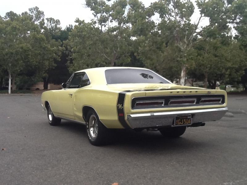

iPadApril2014 297.jpgBig meats transformed the attitude on the R/T. Shoved 295 50 15's on 8" rim back there. Fit without modification, but this is a Coronet.
