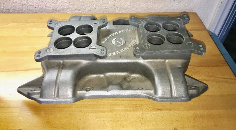

Will the small four barrel Holley carbs fit on the Offenhauser 360 dual quad manifold? The manifold is for the 361-400 low deck engine. I know they will bolt up but will the float bowls have clearance. Thanks.

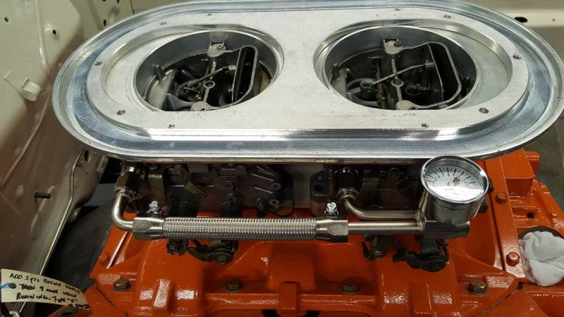

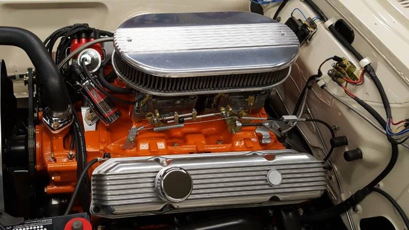

The Factory cast iron has the carbs closer than the Offy. This is the factory cast iron on my BB. The factory oval air cleaners almost touch.

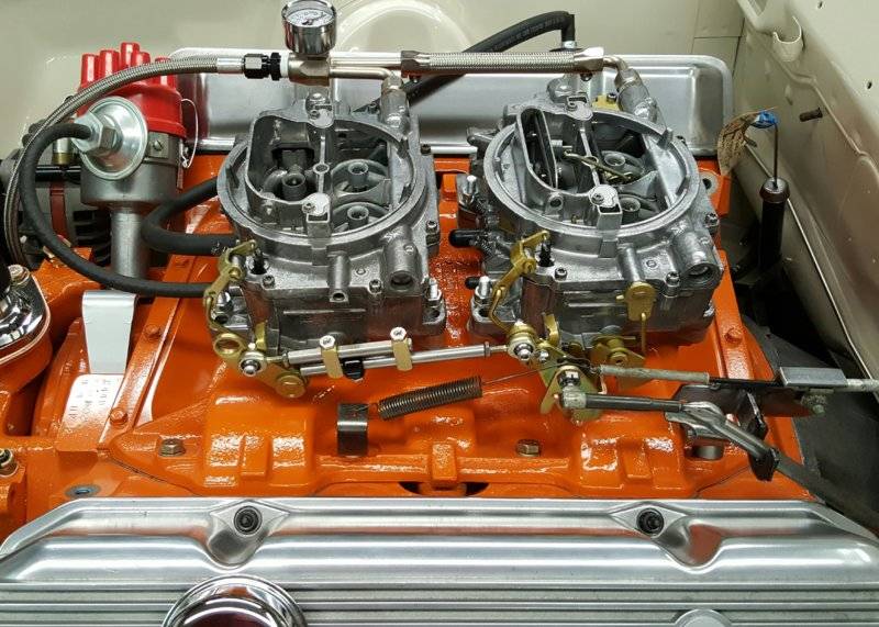

I used a Billit Specialties air cleaner that has an adjustable base.

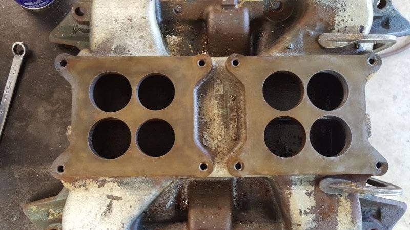

I might add this tidbit... the factory raised block, cast iron manifold is 7" center to center. The 360* Offy for the raised block has a 8-3/4" center to center.

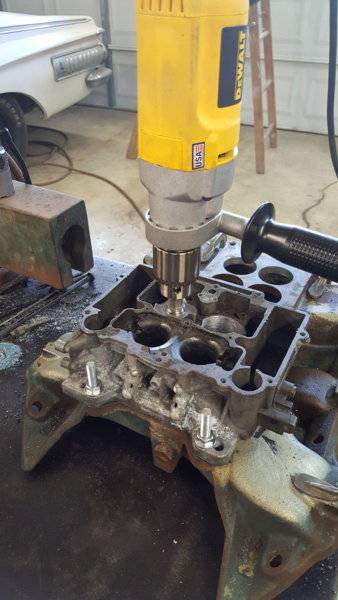

Also the secondary holes in the rb factory cast iron manifold have to be opened up to accept the Eldebrock carbs.
I found a reamer on fleabay the same size as the primarys and used an old carb base for a fixture.
In this pic you can see that I did the ones on the right but not the left yet
