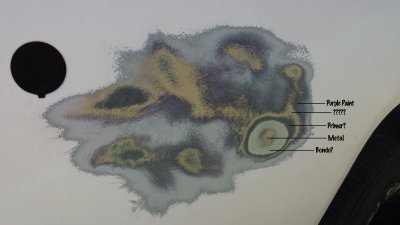

I recently bought a '68 Coronet 440 that needs a paint job. Currently it is a matte white. I'm not sure if it's some kind of primer or what, but it's not good.
Anyway, I sanded through the layers just to see what I'm dealing with (see attached pic). The car used to be purple, so it looks like the last owner just painted over the purple, even though he claimed it was sanded down to metal and painted white. So I'm contemplating doing some of the sanding on this car myself. Not sure if it's worth the time, or if I'd be better off paying a professional to do it. And if I do sand it, how far down do I go? I would love to try painting it myself, but my tandem garage just isn't wide enough to comfortably get around. I've gotten quotes for $6K,with minimal bodywork. The car is pretty straight right now. I don't want a show car (well, I'd like one, but can't afford one), just a really nice weekend (or more) driver. So what are your thoughts - DIY the sanding, or have a pro do it? And if I do it, how far down do I take the sanding?

The yellow just under the purple could be a primer/surfacer applied just before the topcoat of purple to provide a smooth surface for the paint. Get some references for the body shops you are looking at. You don't want it stuck in limbo at the shop while they work on other projects. See what they want to prep it and let them know you aren't looking for a show quality job but a nice daily driver. If you don't have a decent size compressor at home to run a DA this will limit your options unless you want to chemically strip the old paint(very messy) or use a stripper wheel on a angle grinder. Talk to some pros and get some opinions. Good luck.

I used an electric orbital sander to do that small bit. What is a recommended DA sander for doing the entire car? And what size compressor is sufficient? I'd really like to do this myself, if possible.

My car had at least 20 coats and I ended up using a razor blade scraper. The stuff came off in sheets and filled up two 5 gallons buckets! And I think I would take that one down to metal too since the PO lied about it being sanded down to metal before the last paint job. Ain't no telling what else is hiding under the white. Fly by nighters will paint something white because it hides flaws so well.
Cranky you are 100% rite about painting anything white, if i were you n depending on your time frame n if you only want to do this once sand it down to the factory primer n find all the inperfections n fix as needed apply a good sealer primer for any bare metal that is exposed and apply a good base for paint n it should be set for a few years off perfection. Check to see if the recent paint job was applied over areas like the mouldings on trunk lip n doors etc just to see if they did strip the car.
