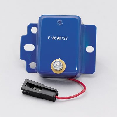

Agree with most of this, exception being the voltage regulator. Yes, it'll work with the old points style regulator -
but if you read the instructions carefully, they do (or at least they used to) strongly recommend conversion
to an electronic regulator (constant voltage to the ECU is a good thing, you know).
In fact, Ma made an electronic regulator specifically for this, utilizing the old wiring in the harness so you didn't
have to do anything new other than swapping out units.
This critter right here:

71 would already have a solid state regulator, no need to change it.
